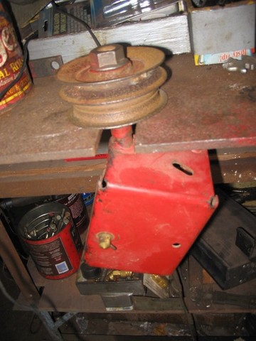

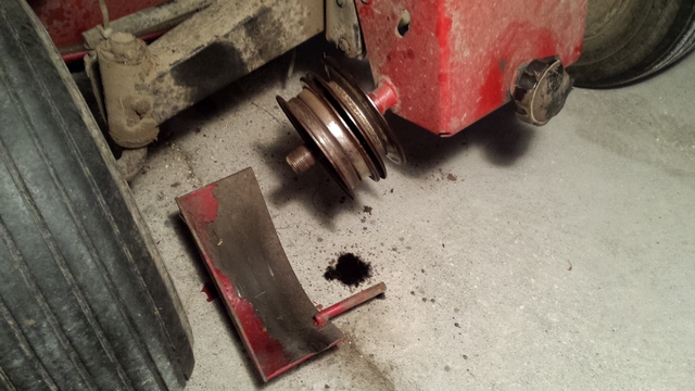

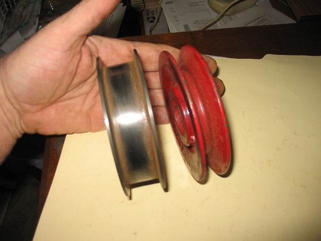

Tvtrader 1 #1 Posted August 1, 2015 My mower deck stopped spinning. I saw a flat spot in the belt and thought it may also be a bearing.After checking I found one deck bearing with excessive play and that the pulley from the motor to the deck was stiff - almost frozen.I loosened it up with some oil but see a small amount of play there.My question is this. will this bearing fail soon and is it pressed on?Is this something I can change my self or do I need a press? Thanks Share this post Link to post Share on other sites
squonk 45,588 #2 Posted August 2, 2015 That bearing is all ready failed. Some can be changed and some you need the whole pulley. Look for a snap ring on the pulley holding the bearing in. And yes you need a press Share this post Link to post Share on other sites

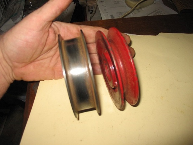

cleat 8,743 #3 Posted August 2, 2015 The flat idler is a stamped steel unit with a none replaceable (well, easily anyways) bearing by looking at the picture, so I assume the v pulley is the same.In that case, I would buy a new pulley (or both if need be) and change them out. Going that route you should not need a press or any special tools. The pulleys should slide off the shaft although they may be rusted on.Cleat Share this post Link to post Share on other sites

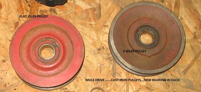

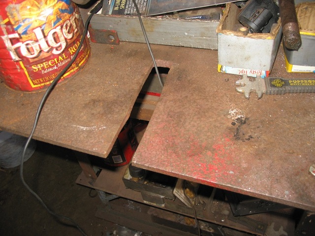

daveoman1966 3,882 #4 Posted August 2, 2015 Original CAST IRON pulleys have replaceable bearings and I have BOTH of them available with NEW BEARINGS already PRESSED in. I can also provide a good used set of Stamped Steel pulleys (like yours). SOMETIMES these pulleys can be a real PITA to get off of the shaft....others slide off effortlessly. Don't lose the two spacers.I cut a slot in my steel-top workbench to remove them. Leave the nut on an smack with hammer until the pulleys break loose...then a wood block to finish the job. for further details, clik my email link here:daveoman@windstream.net 1 Share this post Link to post Share on other sites

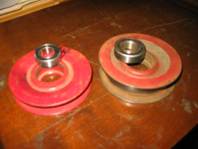

cleat 8,743 #5 Posted August 2, 2015 I bought some cast pulleys from ebay and installed new bearings to replace my bad stamped steel ones.A small amount of never seize on the shaft on reassembly should ensure easy replacement in the future. Share this post Link to post Share on other sites

jackhammer 550 #8 Posted August 3, 2015 But on your V pulley make sure you look inside the V part and slide a finger along in there. It may be grooved over the years of use,, and cause you to have belt troubles prematurely. 1 Share this post Link to post Share on other sites
