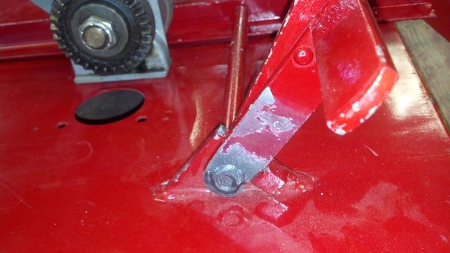

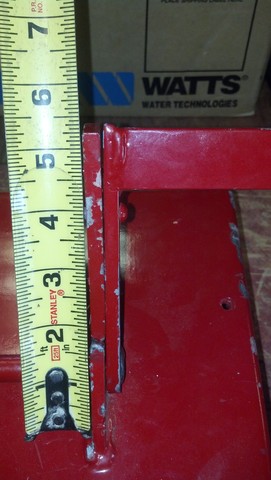

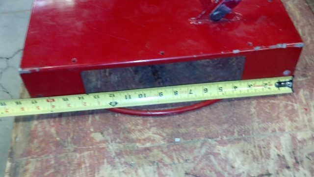

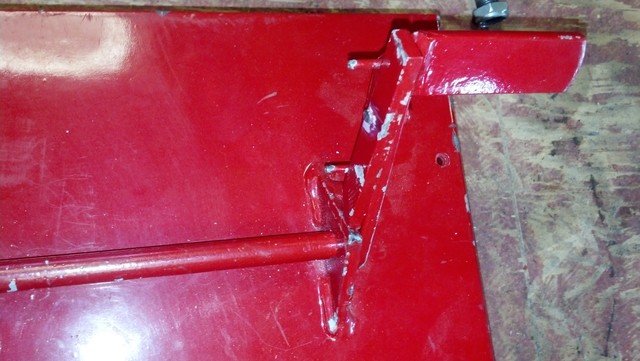

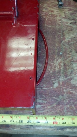

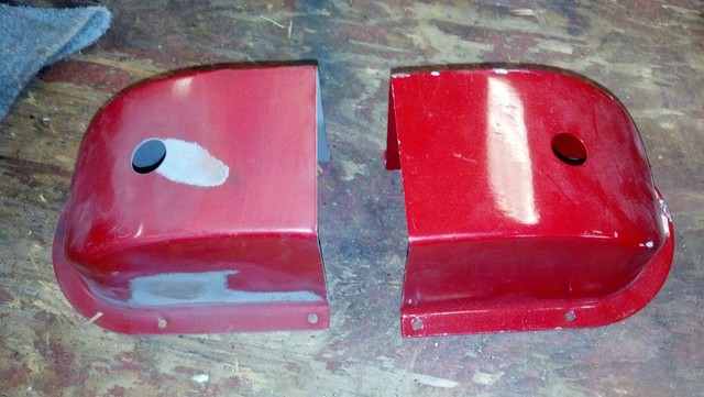

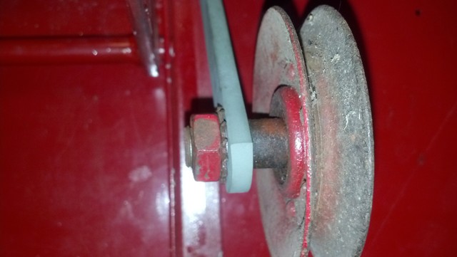

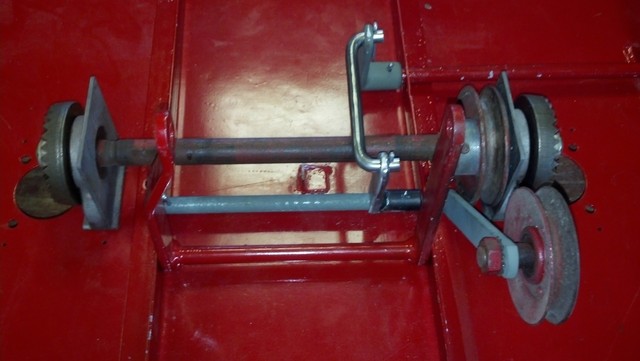

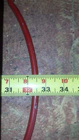

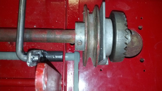

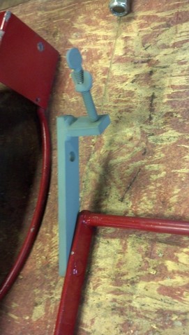

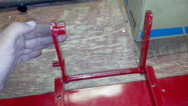

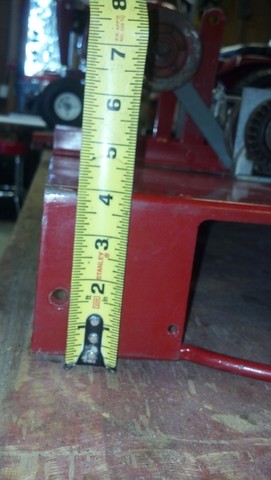

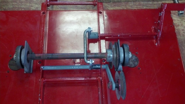

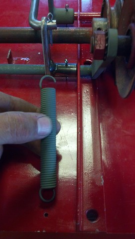

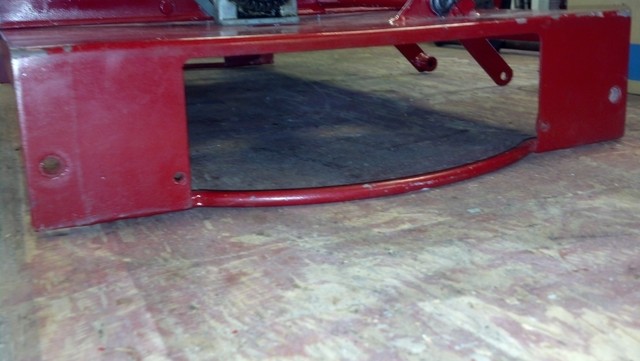

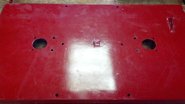

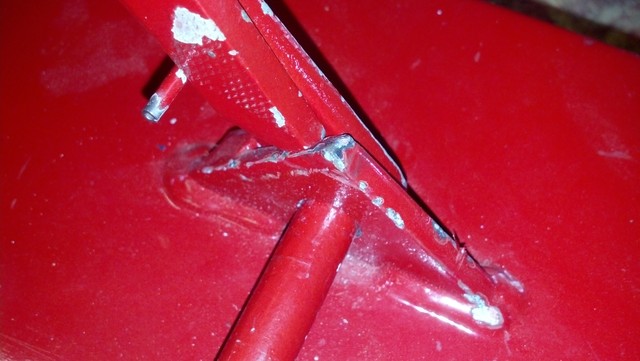

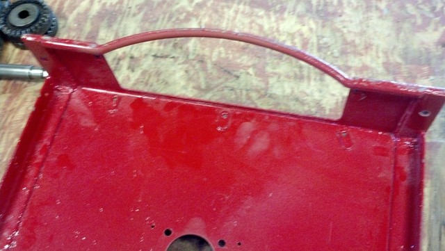

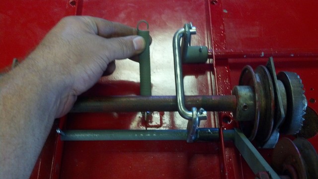

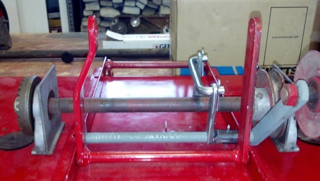

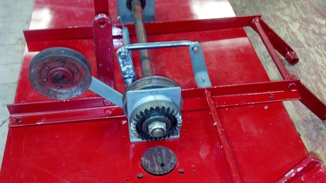

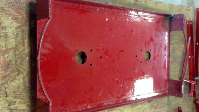

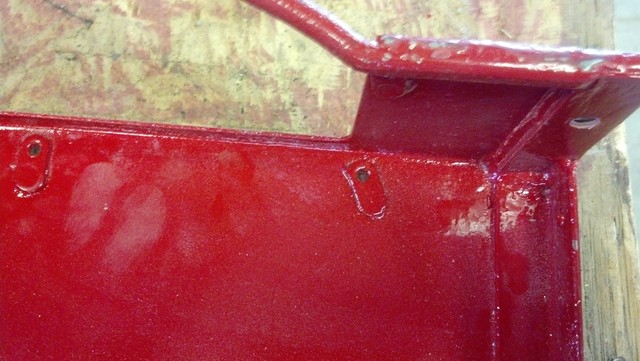

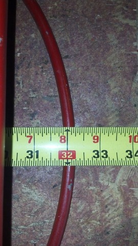

RedRanger 1,470 #5 Posted August 3, 2015 Actually I need the measurements of all parts of the deck so that I can fabricate one at home. but thank you for your help. Here is what I have. The deck, carrier linkage, and clutch engagement could all be easily made. It's all flat stock, round stock, angle iron, and sheet metal.You would need to find a 32 inch gear drive, cross shaft and gears, pair of gear covers and a pair of deck guards for the end. I have a 66 lawn ranger and all the mentioned parts are interchangeable with the RM-3261 and much easier to find. I believe any '60s models 32 inch rear discharge decks would supply the needed moving parts.I've supplied the basic deck measurements in the pictures below. If you need more specific numbers....let me know.As for the deck....Deck box is 29.75 inches without the bump outs.Dimension between the round bars is 31 7/8 inches.Outside dimension of round bars is 32 5/8 inches.I would think a box that is just 32 5/8 wide would eliminate the need for the side openings and would work just fine.Clutch pivot latch.Clutch pedal.Rear carrier hanger.Part of Front carrier hanger.Deck box is 4 inches tall.Deck 17.25 inches front to back.Clutch engagement spring goes from rear pivot down to rear of deck pulling idler pulley backward when the clutch pedal lock is released.There is a second spring that goes from a welded bracket in the center of the deck up to the bottom of the tractor to help the deck "float". I don't believe the spring in the picture is the correct spring.Part two of the front hanger bracket attaches to the lift arm. Wing nut is the deck height adjuster. Sits on top of the tractor frame.Here is a picture of a mostly complete assembled version. 1 Share this post Link to post Share on other sites
