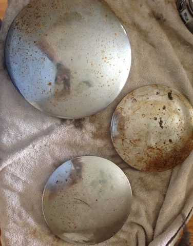

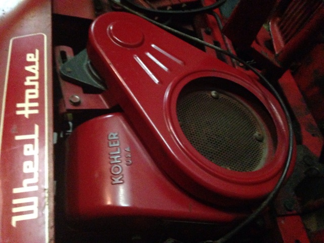

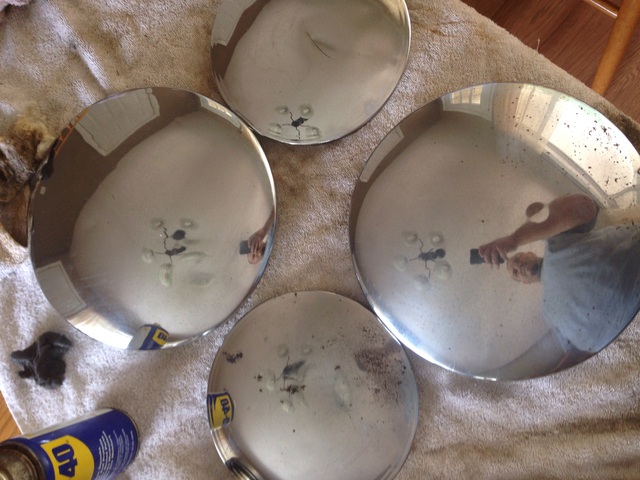

Fire_fighter625 103 #1 Posted July 29, 2015 (edited) These rims cleaned up well!!! I couldn't believe it! Just some WD-40 and fine steel wool. I took it a step further and used a rag and sprayed a little on my motor and hood of my newly purchased 857 for $300 (that runs like a top). Anyways, shined that red motor case right up!! Any cons to using this on the old, original paint? Not wanting to mess with the antique bumps and Knicks so I'm not restoring, just going to clean it up. Edited July 29, 2015 by Fire_fighter625 1 Share this post Link to post Share on other sites

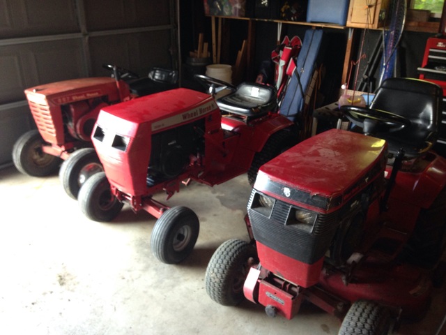

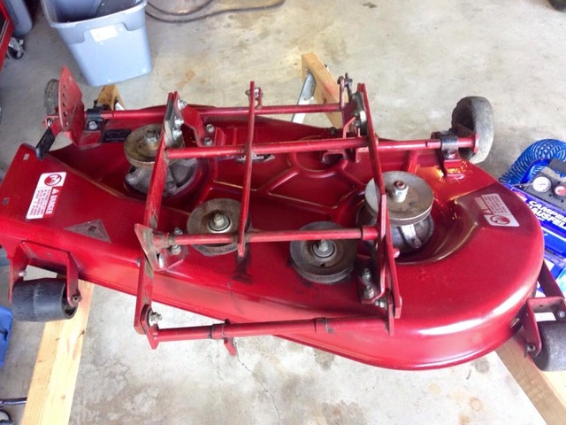

Fire_fighter625 103 #9 Posted July 29, 2015 Had to start somewhere. After 2 years of buying selling and trading, this is what I've got. Last picture lol. I used New Holland red after priming and sanding certain spots on this deck. I've found NH Red (by Majic at TSC) to be an exact match for me. You can't even tell where I touched up. 4 Share this post Link to post Share on other sites
AMC RULES 37,254 #10 Posted July 29, 2015 Holy Batman...that's from a spray can? 1 Share this post Link to post Share on other sites
Fire_fighter625 103 #11 Posted July 29, 2015 Yes, large portions. 1 Share this post Link to post Share on other sites
AMC RULES 37,254 #12 Posted July 29, 2015 Thought I read... that paint takes forever to harden? Confirm, or no? 1 Share this post Link to post Share on other sites
Fire_fighter625 103 #13 Posted July 30, 2015 I've never had an issue with it, AMC. I did leave it set to cure a few days before I touched it. No problems. Now, I'm just needing new deck wheel for 2 decks I have. 1 Share this post Link to post Share on other sites
WHX?? 54,624 #14 Posted August 10, 2015 Can't believe WD cleaned the caps up like that!Problem here Fire Fighter is.... most guys hereare such addicts......myself included...... can't go a few minutes no less than days with out touching it!! Deck wheels should be an easy find at a dealer. 1 Share this post Link to post Share on other sites
Tuneup 1,452 #15 Posted August 11, 2015 Can after can of that stuff at $1.99 with some real fine steel wool and it cleans everything but it's about $5 a freaking can!!! I got a gallon and a spray bottle once and had fun for a year. WD is light kerosene anyway. I'm using old red kero now. Great stuff. Share this post Link to post Share on other sites
callum12 257 #16 Posted August 12, 2015 WD 40, liquid magic! haha Share this post Link to post Share on other sites
