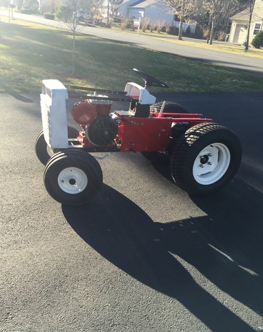

HorseHead1089 100 #126 Posted March 20, 2016 That motor looks mighty clean, to be honest that could be used as a house decoration! 2 Share this post Link to post Share on other sites
dells68 7,499 #127 Posted March 21, 2016 1 hour ago, Aldon said: The K341, 16 hp, was a repower by previous owner. On the GT14, these studs were not being used. I may remove them but have not done so yet. Thanks! Was afraid I was missing something. I agree about the decoration - bring it on over. I'll put it in my living room - for a while, a short while before I put it in my own tractor 1 Share this post Link to post Share on other sites
Aldon 4,832 #128 Posted March 21, 2016 Thanks gents. I kinda like the table on the set of Top Gear. A V8 block with glass top. Might have to do a Kohler end table one of these days:-) I need a couple nice days so I can paint up the engine covers. And the front rims. Then I can make tons of progress. 1 Share this post Link to post Share on other sites

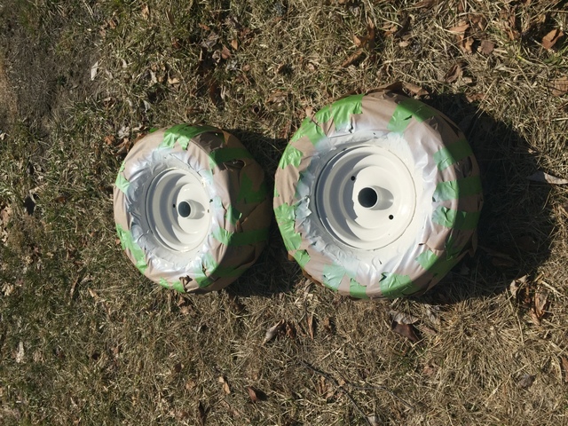

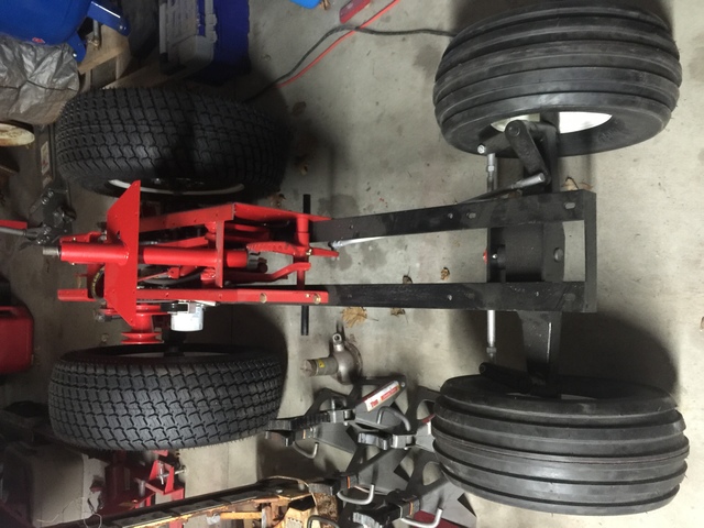

Aldon 4,832 #129 Posted March 31, 2016 Had Mmmmdonuts over to house last weekend and did some sandblasting for him. I managed to get the Restomods front wheels re-blasted. Took me quite a bit of time to repair the damage the Mavis monkeys did. And the closest paint i found To the powdercoat is a close but not exact match. Guess I'm glad these tractors are not concourse judged. Today I took advantage of good weather to get them painted so with luck, I'll be able to move forward with the restore in earnest. Although weather is supposed to turn for worse again this weekend. Here is the required pic 3 Share this post Link to post Share on other sites

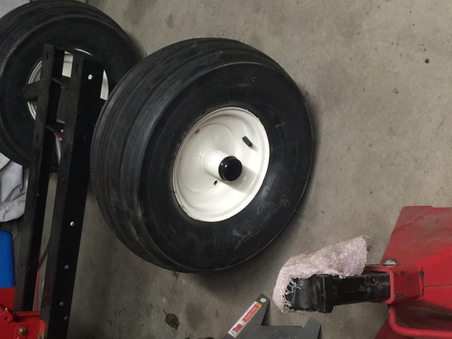

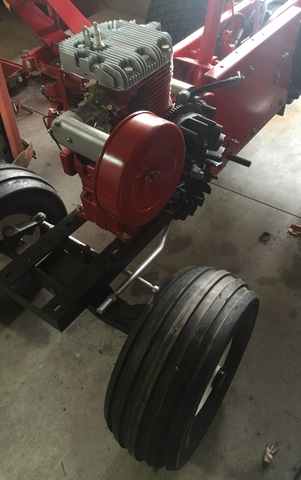

Aldon 4,832 #130 Posted April 2, 2016 Just in time for the snow and cold temps, I was able to get the project back on track. In the low light of the garage, the color of the fronts is hard to differentiate from a the powdercoated rear rims. I will be able to mount the engine this weekend if temps don't drop too much. the new bearing races or whatever you call that beveled piece thats pressed into wheel for bearing to rest against were a serious PITA task.... That was with warming the rim, new part in freezer and with the right tools. Worst set of rims I have done this far. 4 Share this post Link to post Share on other sites

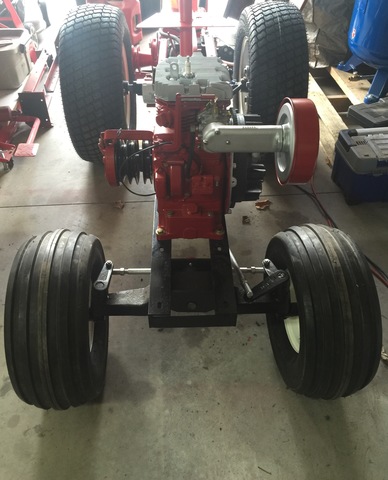

Aldon 4,832 #131 Posted April 2, 2016 Between cold front and other obligations this weekend, may not make a lot of headway. But...... Significant Milestone: The Eagle has landed...we uh...Engine is mounted. Finally. Now I need temps to reach paint and body levels. 7 Share this post Link to post Share on other sites

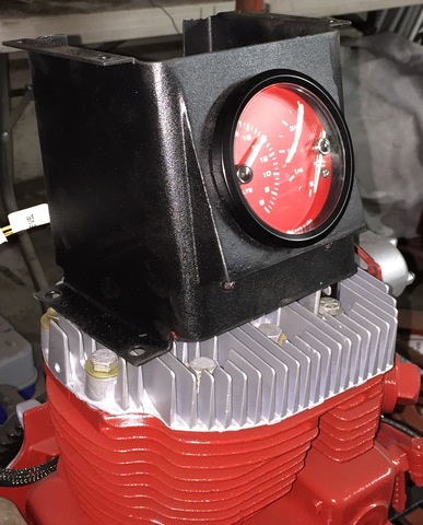

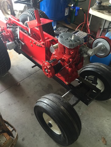

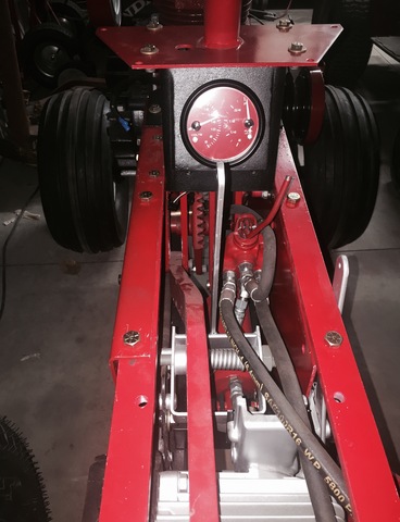

Aldon 4,832 #132 Posted April 10, 2016 So I cleared a significant hurdle. Got the dash tower support welded and painted up. Dual gage is installed on it. Pic is of the dash tower sitting atop the engine. Running out of horizontal space!!! Next warmer day I have that I can work on the project I should be able to mount the support rails, dash tower and battery tray. I can temporarily mount a tank and nose piece and fire it up and test Hydro function and set neutral while I can more freely access the hydro cam. Then wait on continuous warmer weather to tackle body work and paint. The rear fenders always tear. Due to owners using them to support dismount among other reasons. I am thinking of having some support steel added. My welding is not practiced or good enough so I may have to seek a fab or body shop. I think it's a modification worth doing depending on cost. 4 Share this post Link to post Share on other sites

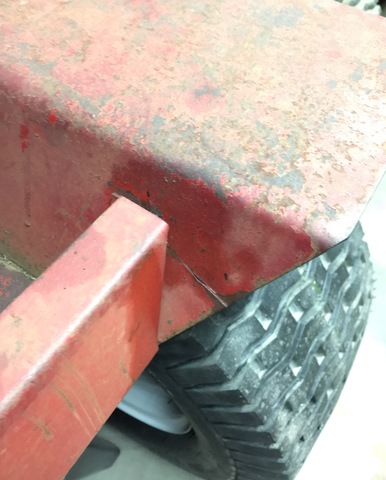

ztnoo 2,302 #133 Posted April 10, 2016 Aldon, The ammeter/gas gauge looks absolutely super. Great idea and great execution!!! The fender corner thing is almost universal. It's kinda natural to slide one's ass over either fender while mounting or dismounting the tractor. I've found myself leaning my derriere on those countless times. Virtually every GT 14 I've seen suffers the same affliction. You're wise to beef it up by back plating, triangulation, or whatever. When you're 80 years old and sittin' your butt on those fenders to catch your breath from yard chores, you'll be glad you went to the trouble. 3 Share this post Link to post Share on other sites

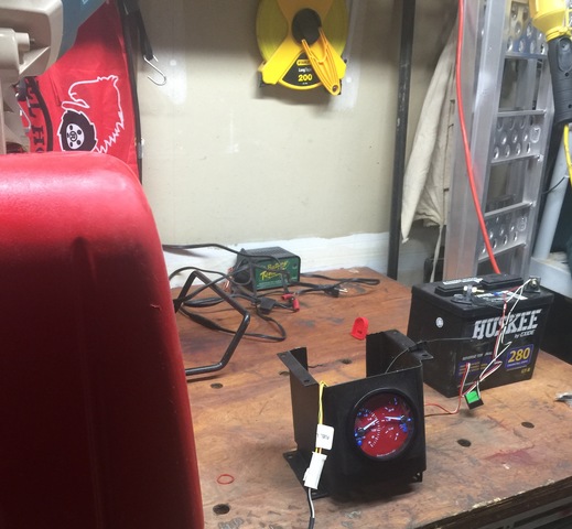

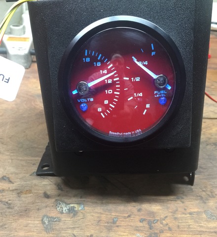

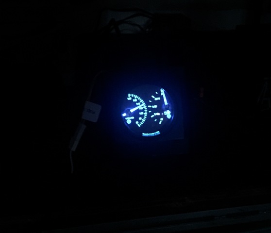

Aldon 4,832 #134 Posted April 13, 2016 Some more progress that will move me a chunk closer to my end goal. Bench tested and calibrated the fuel sender and gage. Then installed the tower. I must mention that this was one of the most tedious jigsaw puzzles I have dealt with in a while. If not for the 2nd tractor sitting whole in close proximity it may hve taken a lot more time and likely would have stretched my patience to its boundaries! This gage is really nice custom add but doubt the light feature is all that necessary. Although for snow removal if ever used in that capacity it would be nice luxury. As it's always dark, either before sunrise or after sundown when I am removing snow. 7 Share this post Link to post Share on other sites
ztnoo 2,302 #135 Posted April 13, 2016 (edited) WOW MAN!!! Sharp, REALLY, REALLY SHARP!!! That thing is a lot bigger than I imagined. Very visible in the dark. Impressive Mr. T! You scored a game winning goal with the thought, set up, and execution!!! As Gomer use to say, Edited April 14, 2016 by ztnoo 2 Share this post Link to post Share on other sites

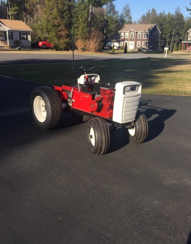

Aldon 4,832 #137 Posted April 14, 2016 I pulled the Resto-mod out for some sun and took advantage of it and the warmth to mock up some additional parts that still need paint so I can do some of the customization for the Oil dip stick tube. In light of day, it's obvious I need to do lots of touch up paint due to sitting in garage for past few months and no matter how careful I am as I reassemble it, I inevitably add a scratch for seemingly every part I install. I kinda like the look but the white will be red for most part. Dropped the rear fenders at the fabrication shop to be strengthened as well today. 6 Share this post Link to post Share on other sites
ztnoo 2,302 #138 Posted April 14, 2016 Mr. T, So.....what exactly was decided on to reinforce those oh so crackable inside fender corners? z p.s. Bright sunshine in upstate NY.........how did that happen??? 1 Share this post Link to post Share on other sites
JPWH 6,544 #139 Posted April 14, 2016 Looking awsome! I know what you mean on the scratches. 1 Share this post Link to post Share on other sites
Aldon 4,832 #140 Posted April 14, 2016 It's easier to just wait two weeks and I'll post pics. Hopefully the sheet metal is still good when I get it back. They are a professional shop with experienced fabricators so I hope so. Basically adding steel under the fenders but also along and up the sides of the rear piece that the fenders tie into. My theory is that it will tie the support more firmly to the tractor frame. Time will tell. 1 Share this post Link to post Share on other sites

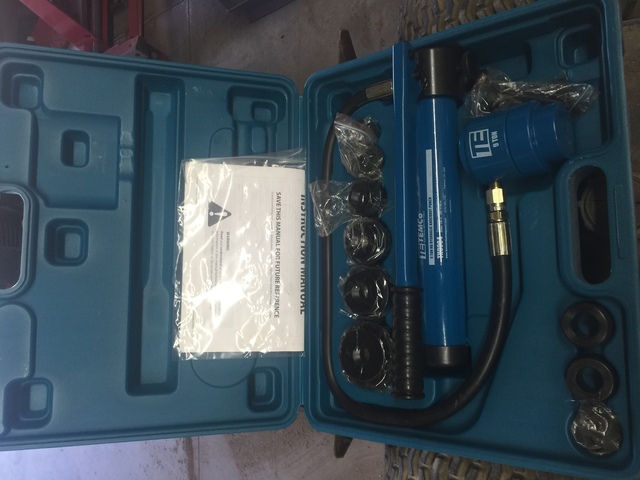

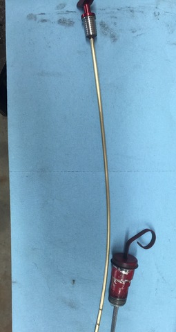

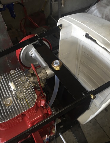

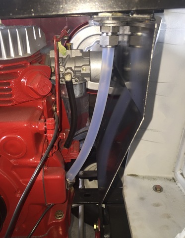

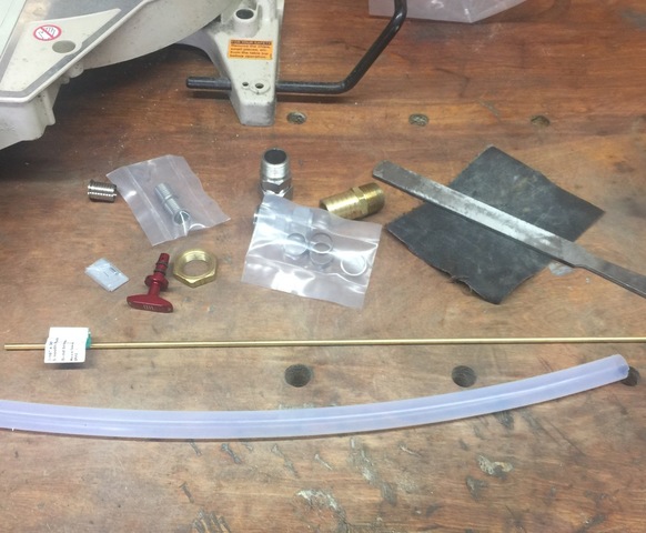

Aldon 4,832 #141 Posted April 18, 2016 (edited) I spent a couple hours working on the custom Dipstick tube and mounting. Figured I would post a teaser pic. Hopefully I will have it mocked up completely in next few days. Basically the intitial supplies...not seen in this photo is some red 3/4 inch heat shrink and the tank heat shield. Also used this new hydraulic punch which is my favorite toy/tool for today. Edited April 18, 2016 by Aldon 1 Share this post Link to post Share on other sites

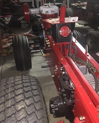

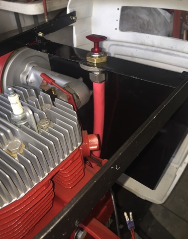

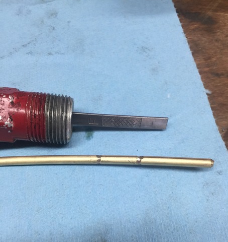

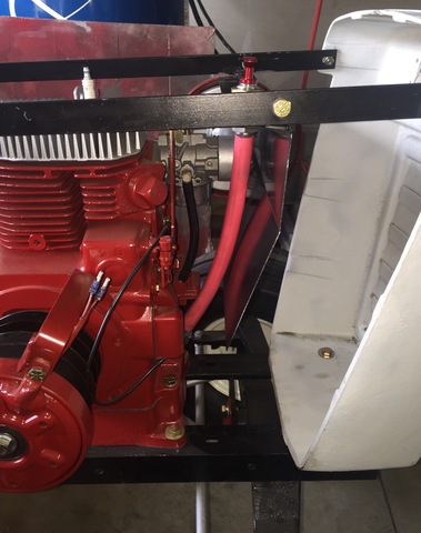

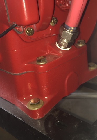

Aldon 4,832 #142 Posted April 18, 2016 (edited) And the rest of the story... Basically I filled oil with original dipstick installed, removed, install d new set up, then made mark on new stick at full mark. Then using old dipstick marked with low level mark. Tube is PFA Teflon tubing. Stainless compression to 3/4 NPT fittings. Used the punch to mount fitting in top of shield. I had to get creative on the brass female nut but it looks decent enough. Then marine grade red 3/4 inch red heat shrink. I did not like the look of the PFA and paint does not adhere. The dipstick itself is a aluminum Tee handle off eBay mated to brass rod from tractor supply. Drilled and pinned. Then potted or epoxied into stainless barbed fitting that was part of the compression fitting but repurposed. Then I filed the barbed edge down a bit. Plenty of hood clearance and I think it adds a nice custom touch. L Edited April 18, 2016 by Aldon 8 Share this post Link to post Share on other sites

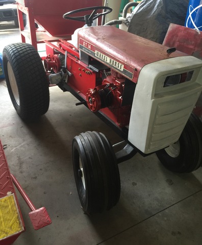

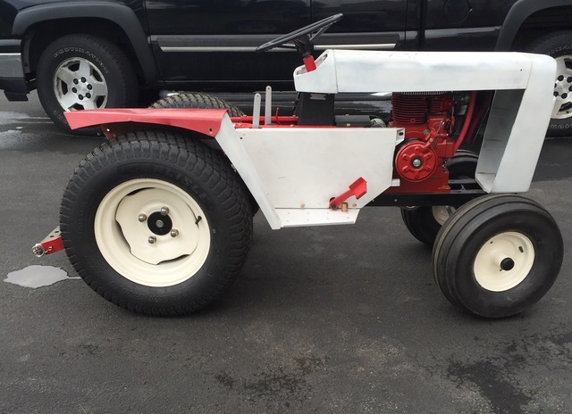

Aldon 4,832 #143 Posted April 18, 2016 (edited) Decided to steal hood off of Lazarus and see how it looks so far. I may may not get the foot control Hydro wrapped up by the big show but should have this puppy close to done. Close enough to bring and ride around on. Edited April 19, 2016 by Aldon 6 Share this post Link to post Share on other sites
ztnoo 2,302 #144 Posted April 18, 2016 Aldon, Well, once again you've knocked a home run.......way, way out of the park! Obviously well thought out, using an unusual mix of different pieces of hardware, along with some things which were made for measuring oil, and applied them to your very personal and unique situation. It looks FANTABULOUS!!! Certainly imaginative and ingenious. I tip my hat to you, Sir Trimble! How did you determine how long the dipstick had to be to start off with your fabrication? ------------------ Nothing like a "good" hood off Lazarus. 2 Share this post Link to post Share on other sites

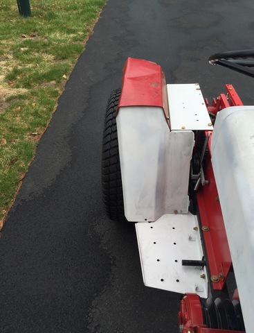

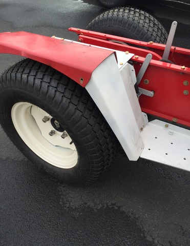

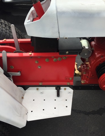

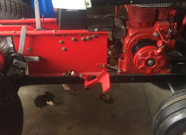

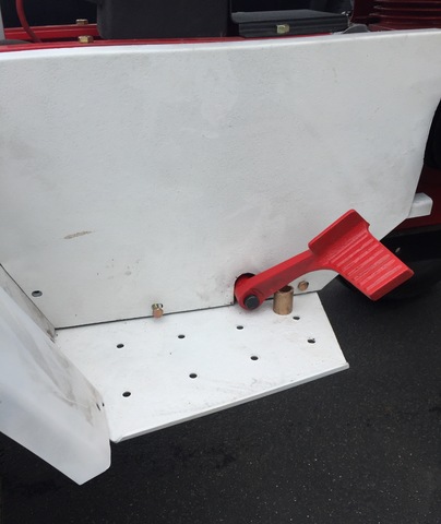

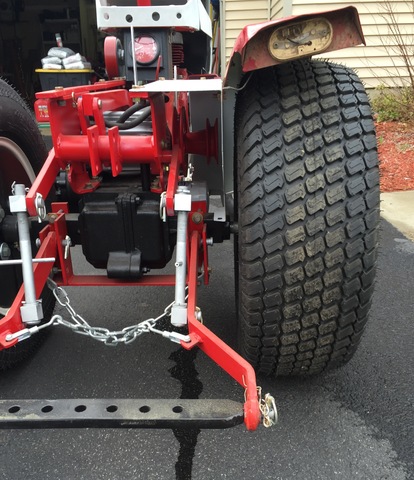

Aldon 4,832 #146 Posted April 23, 2016 I realized that I needed to modify the right side tread plate and belt guard due to the foot pedal I added for the eventual hydro control so since I am in a holding pattern waiting for the welding/fab fella to finish my rear fenders I tackled the modification today. Decided to take a couple extra pics for anyone considering adding Carlisles to the rear. It looks like height is same and width is a bit larger. You lose about a half inch of internal clearance from inner fender to inside edge of tire. First the mod. I basically copied the left side of tractor. Had to add a couple pieces and a fender that was in scrap heap since I am short a couple right now. If I don't get hydro control wrapped up before show, I will lock the pedal in place so it will temporarily be a foot rest. 7 Share this post Link to post Share on other sites
stevebo-(Moderator) 8,664 #147 Posted April 23, 2016 Looking really good. Might have to find yourself a nice 60" deck for it 1 Share this post Link to post Share on other sites
Aldon 4,832 #148 Posted April 23, 2016 17 minutes ago, stevebo said: Looking really good. Might have to find yourself a nice 60" deck for it Hmmm. Wonder who might have one? Its gonna be a 10footer. Paint and body work is not my forte. Yet:-) But mechanically it should last another half century. 3 Share this post Link to post Share on other sites
stevebo-(Moderator) 8,664 #149 Posted April 23, 2016 It is looking pretty darn good so far. 2 Share this post Link to post Share on other sites

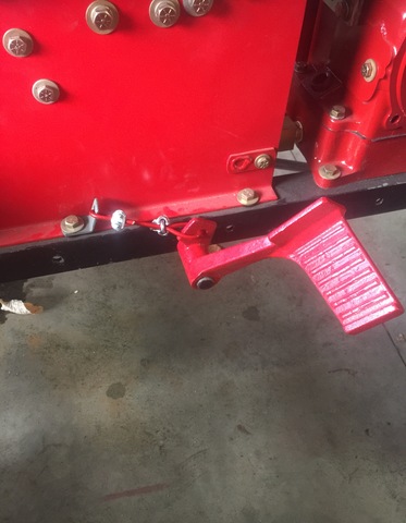

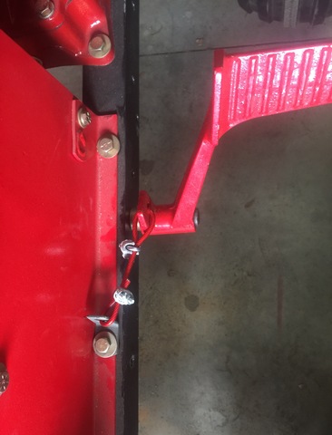

Aldon 4,832 #150 Posted April 23, 2016 the project time and task budget is tight so I am going to hope for best and plan for worst. Went ahead and rigged the foot pedal into a static foot rest. Easy to move forward with hydro foot control if time allows and easy to finish later if need be. Not the most eloquent fix but it clears the belt guard and will suffice. 6 Share this post Link to post Share on other sites
