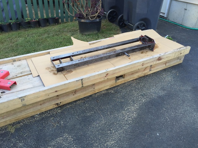

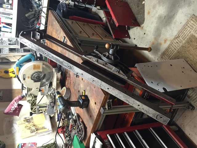

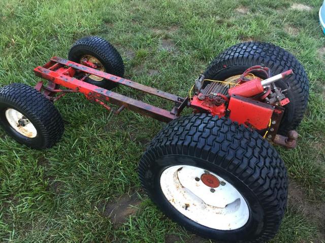

Well I made some progress this week in spite of work and family obligations. I managed to get the parts tractor torn down to frame. Degreased it tonight and should be able to get it blasted and primed in next day or two. I will lose a few days next week as I am headed to Indiana. My next step is
will be to measure and fit the attach-a-matic brackets. Also take a crack and adding foot pedal hydro control in that has a factory look to it. Then I should be ready to start painting or and I am seriously considering at this point, taking it to have it powder coated. I will probably  take it to get it quoted and let price dictate paint or powder coat. At the pace I am going I figure 6-8 weeks to be done with tractor. Looking like an early spring wrap up unless I go powder coat route which may also factor in.image.thumb.jpg.f89e991a55163aff5240e8f9image.thumb.jpg.b43898d98ebc82a965527b55

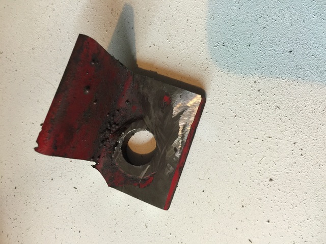

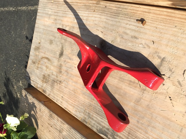

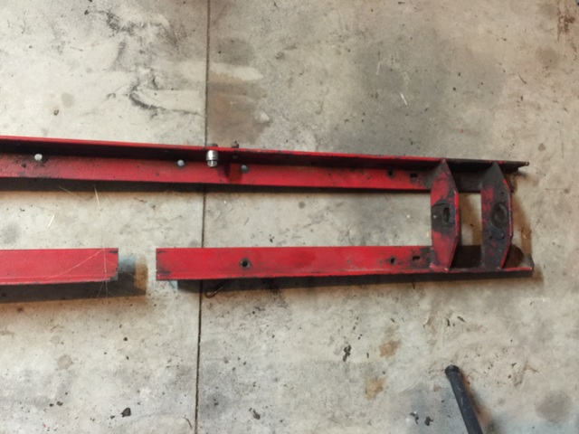

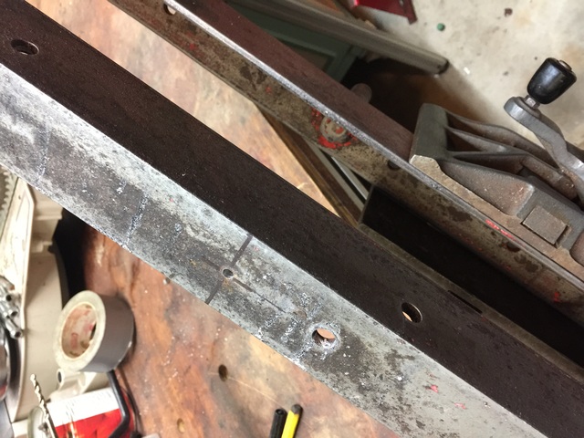

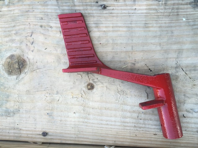

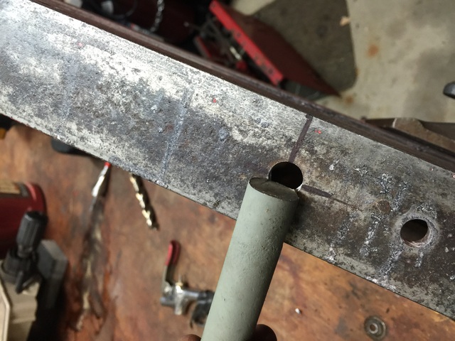

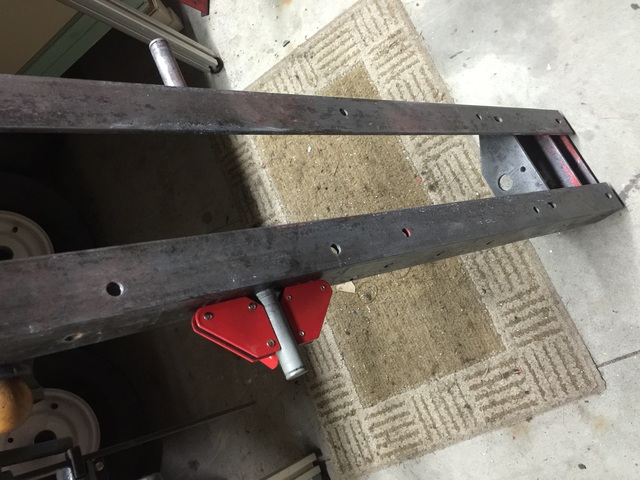

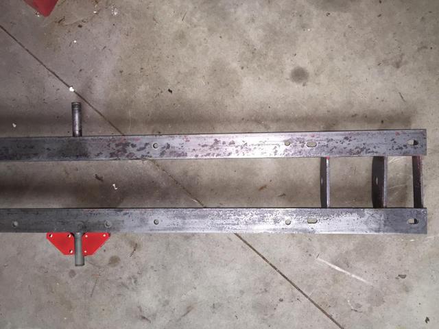

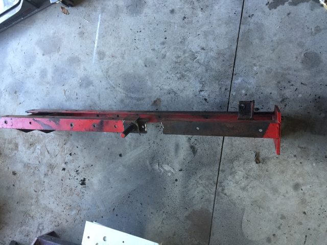

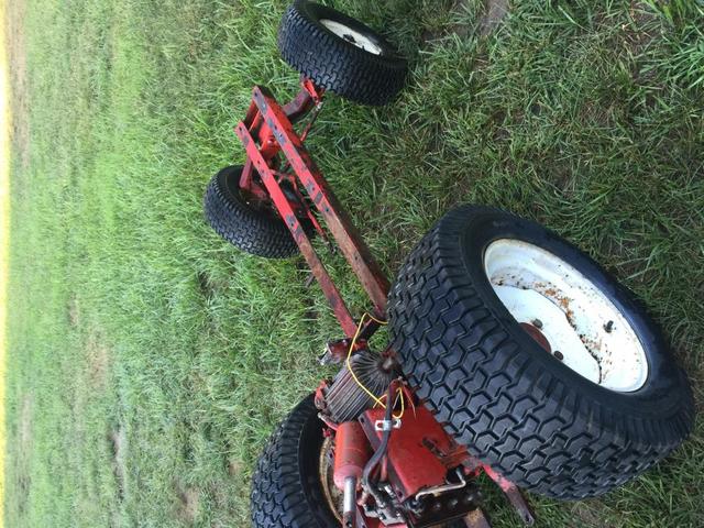

I hit the shop before 8 am hoping to get some work done before temps drove me to my knees. While it hit above 90 the humidity stayed resonable so I put in a pretty full day. Odds and end stuff but I also managed to remove the front axle assembly and got the frame almost ready for prime. I need to have the foot pedal peg welded to the right side of frame and going to have the front cross piece strengthened. If all goes well I will get this over to welder this week. I am actually a decent welder but have yet to purchase a welder. It's in the queue of items I wish to get along with a powder coat oven.

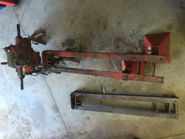

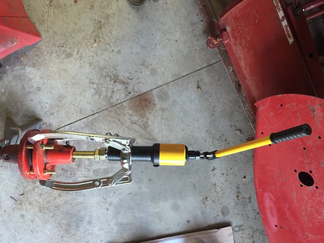

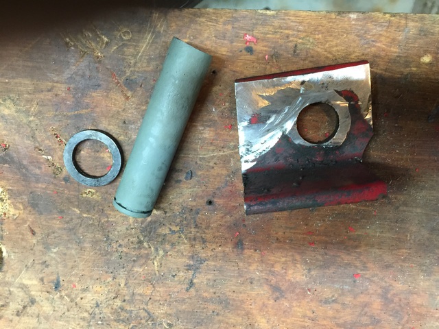

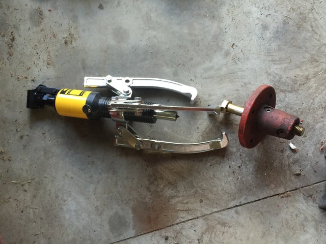

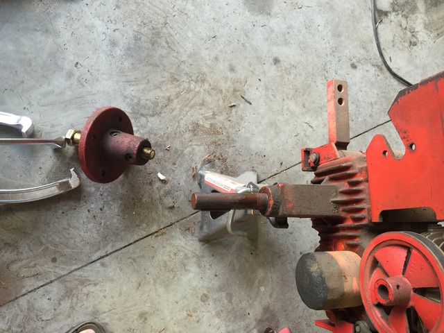

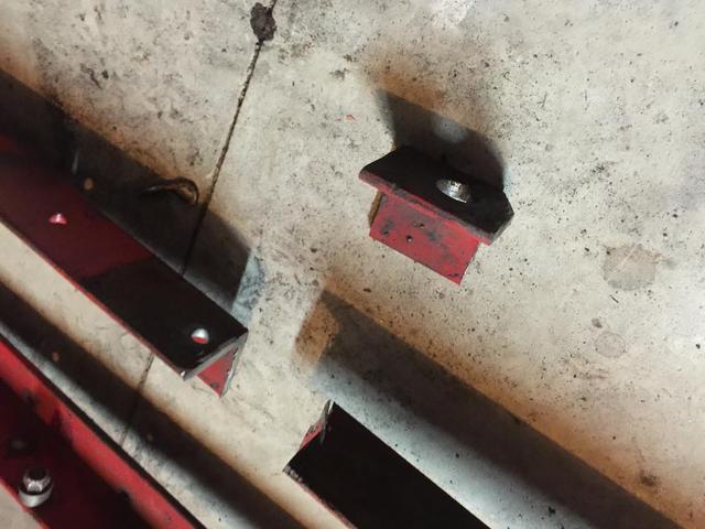

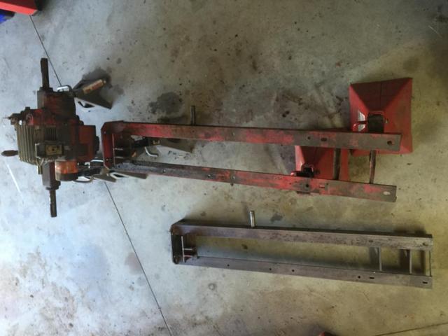

Very busy work week so did not get much done until this afternoon. So I am busy trying to wrap up all the loose ends. One of those loose ends is that I have been trying fruitlessly to free the right side rear hub from the Hydro I plan to use on the tractor. I broke 4 different pullers in the process. Eventually got to point where I could use hub from opposite side as others on the forum have done. Just could not get the leverage necessary. I finally decided it wa stone to go big or give up. Bought the hydraulic puller below from Amazon for a C note. I should have made this investment ages ago. Once I got it in position I had it off in no time. I initially had set it up with a Grade 8 nut between the ram and bolt head as ram had a centering point. Then I realized that centering point gives way under pressure. Very pleased with how easy this is in comparison to prior efforts. I will say that it required all the muscle that the 10 ton puller had. But the puller won this round :greetings-clappingyellow:image.thumb.jpg.25182b5ff470361f80f4f582image.thumb.jpg.5ff9683dbb95a465ba27a307image.thumb.jpg.d33c6f9976686498a510756e
  • Like 5

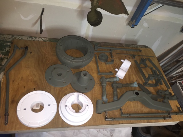

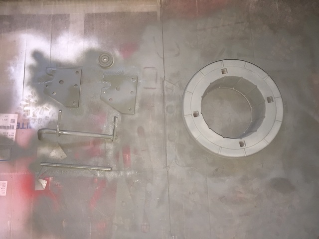

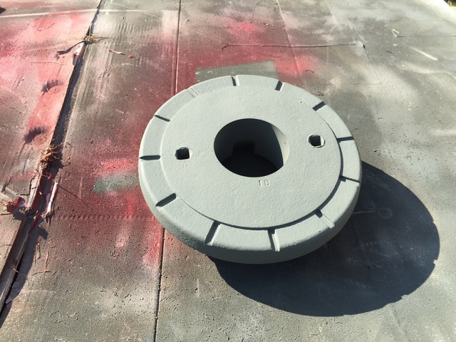

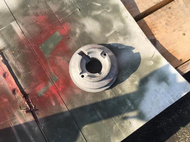

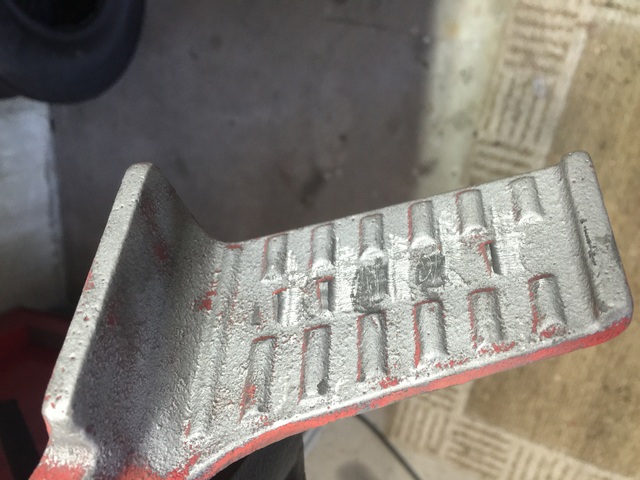

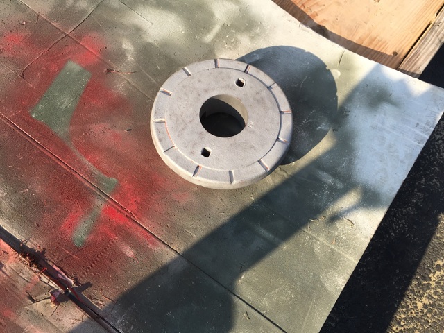

Well am waiting on Hyrdraulic parts, need to find a Welder(only been local a couple years) and have to get some Black Diamond. Spent Saturday morning trying to resuscitate the power washer. No Go. I could spend time and money on new valve but unit was only nominally powerful enough. Will try and work without and upgrade in spring. So need extra media to blast outdoors. But I started cleaning up and doing all the Smalls. Did not think I accomplished much but as I gathered it all for a photo for documentation purposes, not a bad couple shortened days.
Photos not great as indoors and I have used the backing so much it matches the parts.
The rear weights I picked up earlier this summer from Forum friend in CT. Decided as long as I am in blast mode, why not knock the rust off and repaint. These days if it's not nailed down and its metal, it gets the refresh:-)
The Hydro engage lever and adjustment rats nest were the last parts done along with front axle assembly.
Down to cleaning and painting the Hydro itself, then the Frame once welded. While I may not get finish coat done before winter, I think I can get it done in early spring worst case.

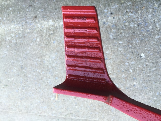

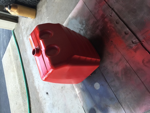

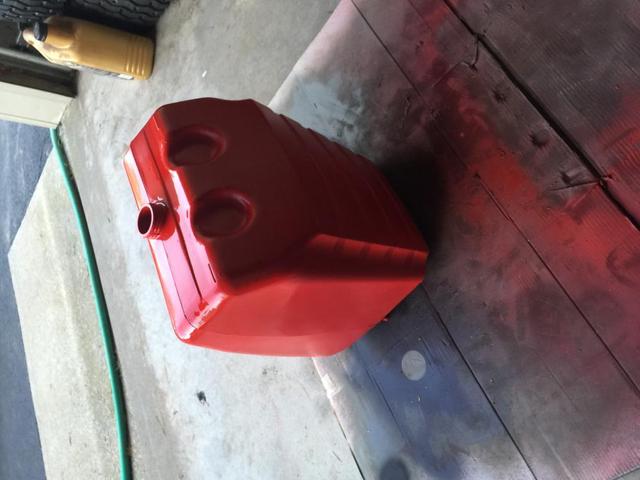

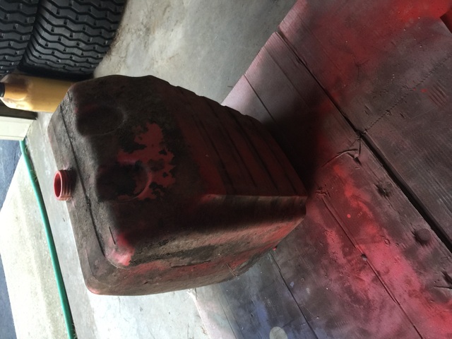

image.thumb.jpg.2b3d678331c67d40340447adimage.thumb.jpg.49a81fbdd32b66e721590b4fBefore / After pics of gas tank. Using Vinyl Dye.
  • Like 3
That looks real good. Like new again. You will have a new tractor when you are done.

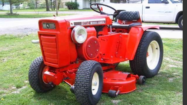

image.thumb.jpg.c917e26850d543972af49299That's my plan. It will look a lot like the GT14 Elliot Ness added to gallery recently which I pilfered to add here. I hope to get tractor finished no later than early spring. Then tackle the 54 in blade, 48 inch deck and rototiller so all are matching paint wise.

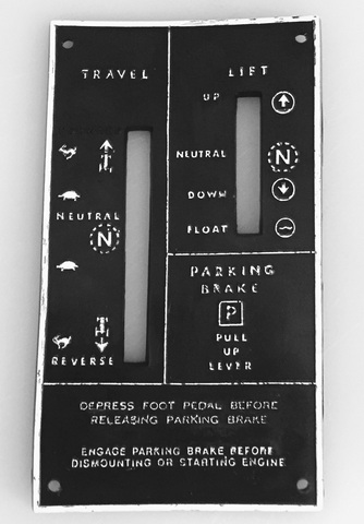

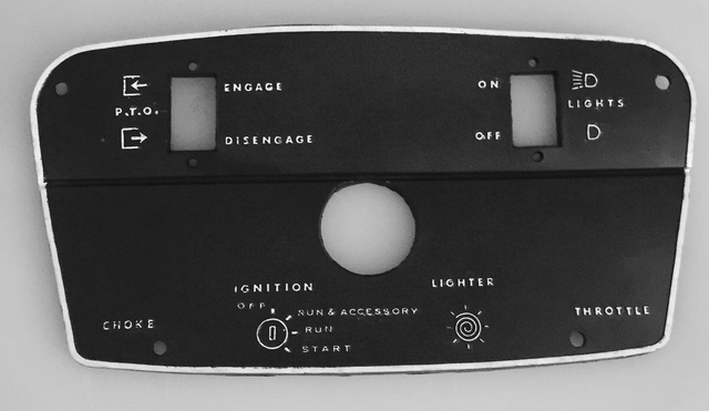

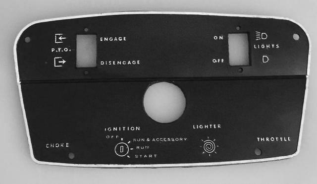

Bought a set of panels from Forum Vendor Glen Pettit. Using the advice in the forum I made the first pass with the paint marker. Need to wait for daylight to see if a second pass is necessary.image.thumb.jpg.2e529a82c886aa60c82e65d9
Edited by Aldon
Bought a set of panels from Forum Vendor Glen Pettit. Using the advice in the forum I made the first pass with the paint market. Need to wait for daylight to see if a second pass is necessary.image.thumb.jpg.2e529a82c886aa60c82e65d9
Glenn reproduces these?
Yes. Glen Pettit in Vendor section. The white over painting of text needs added by the purchaser.

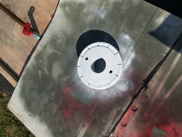

Here is the tunnel plate's similar first pass....Patience is not one of my virtues and this is a tedious process. But it did give me something to do while watching colts lose first half to Jets. Now I can let the paint dry and watch remainder.

Panels are looking good. Did you use a paint marker?
Yes Hank01. MikesRJ thread in Instrctional/restoration/panel forum walks a person through the process. I used same paint pen. I used the fine point though. I can't recall what MIKESRJ called for. I have both the Fine and Medium tipped white paint pens but for me, fine was easier. Takes a steady hand and my bifocal vision made it a challenge in light conditions.
I also have an original panel in good physical condition that I plan to do full process on using the black vinyl dye to freshen up along with paint marker.

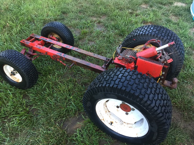

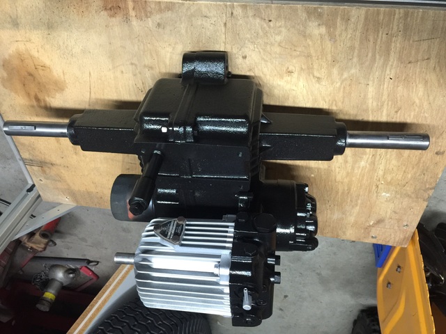

It looks like it might be early next week before I get the Cam Block and plastic Cam replaced and figured the Hydro and Motor deserve to be bragged about a bit:-) Also got the frame and hydro foot peg mocked up and ready to weld in place....and lots of internal parts painted but no pics of those until they are on the tractor again.

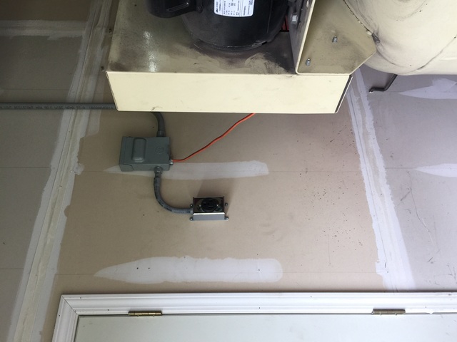

Was also able to add a 220 receptacle for my welder this afternoon.
