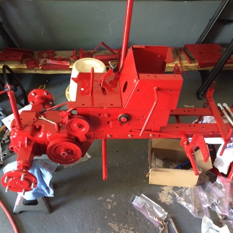

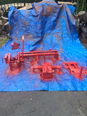

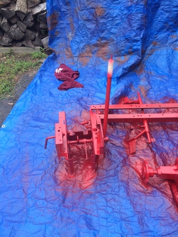

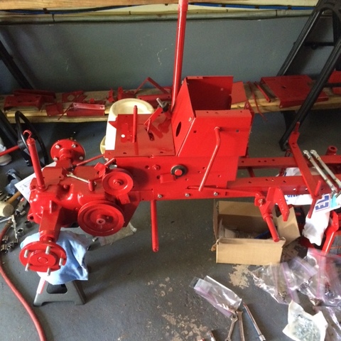

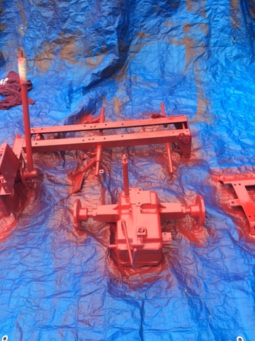

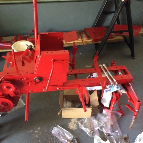

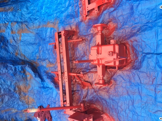

rracioppi 2 #1 Posted July 26, 2015 So I decided to restore the C121 I aquired, I took every bolt out and I am in the process of rebuilding, I need some help with the small screws that go into the block for the points cover, I cant find anywhere a diagram showing what size they are and I have every document I could find on the web, I misplaced them. 2 Share this post Link to post Share on other sites

KC9KAS 4,744 #8 Posted July 27, 2015 And your restore looks very nice. Share this post Link to post Share on other sites
doc724 925 #9 Posted July 27, 2015 Your restoration looks very nice. Having done this several times (and others will agree), taking pix along the way helps with the reassembly process. The parts diagrams are not accurate enough. Also, I have found that as you disassemble sub assemblies, put all the hardware for each sub into zip lock bags and label the bags. If you buy new hardware, it makes it so much easier to get everything right and even if you don't, it makes putting the correct hardware back in the correct spot easier as well. Share this post Link to post Share on other sites
