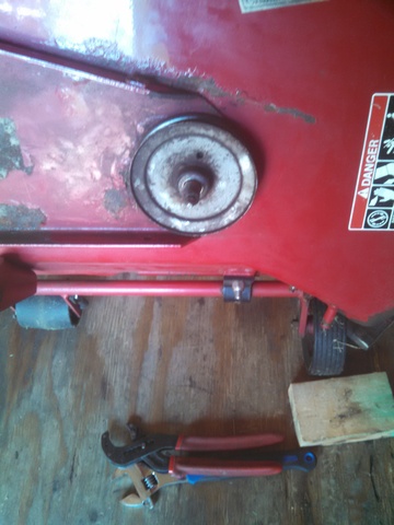

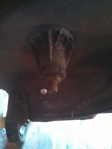

608KEB 808 #1 Posted July 24, 2015 I took these apart before. Now I'm struggling to get the pulley off. I want to take the spindles out. Suggestions? 48" SD model# 78360 Share this post Link to post Share on other sites

groundhog47 347 #8 Posted July 25, 2015 (edited) If you have a bearing separator (clam shell) puller fasten/tighten it to groove in side of very inner most portion of hub (it's about an inch dia). Afix regular 2 post/screw/bolt puller to holes in bearing separator, put a less than 3/4" nut or several thick washers atop spindle (keeps from burring zerk threads), and turn away. It works fine on 42's and should work on the 48's. If you don't have that set up just use caution with hammer, the key will follow through and "blow" your bearing spacer on 3/4" shaft (not on metric bearing keyless shaft).I see some of these pulleys don't have the groove; hope yours does. Edited July 25, 2015 by groundhog47 Share this post Link to post Share on other sites

daveoman1966 3,880 #10 Posted July 25, 2015 On SOME of the later models, the top pulley has a groove cut into the inner hub and the specific purpose for that groove is to remove the pulley. This is the EXACT same setup used on automotive POWER STEERING PUMP PULLEYS and there is a special tool designed to remove that pulley. Autozone will rent you this SPECIAL TOOLHere is a short U-tube video of how it works....PS.... this works ONLY on pulleys with the groove in hub...36 42 or 48 inch deckshttps://www.youtube.com/watch?v=YIiUioLhOxc Share this post Link to post Share on other sites
608KEB 808 #11 Posted July 26, 2015 (edited) No big hurry. I'm using my 42" SD for now. Thanks for the ideas. Will a bearing seperator fit underneath the pulley? Anyone have a few pictures? I saw a bearing puller for $30.00 at harbor freight. Edited July 26, 2015 by 608KEB Share this post Link to post Share on other sites
can whlvr 994 #12 Posted July 27, 2015 I have put a large pipe wrench on the pulley center shaft,a little heat and a pipe on the pipe wrench for leverage and the pulley will move,ya it eats up the middle of the pulley but it doesn't really hurt anything other then looks Share this post Link to post Share on other sites
groundhog47 347 #13 Posted July 27, 2015 No big hurry. I'm using my 42" SD for now. Thanks for the ideas. Will a bearing seperator fit underneath the pulley? Anyone have a few pictures? I saw a bearing puller for $30.00 at harbor freight. Sometimes it will but will bend up the bottom unless pulley is VERY loose. And the 48's big pulleys would require a big beating separator. It would be best to pull from topside as those pulleys are so expensive. Share this post Link to post Share on other sites
