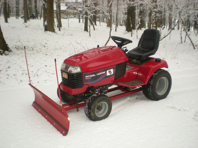

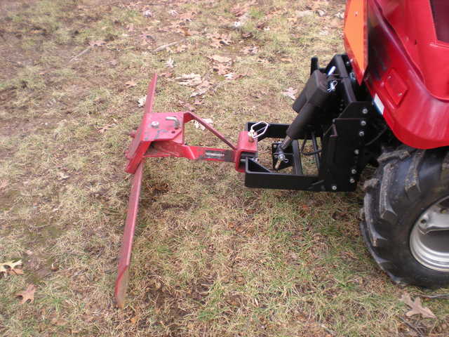

shallowwatersailor 3,216 #3 Posted July 25, 2015 Johnny Bucket makes an electric actuator sleeve hitch that works independent of the rockshaft. I'm not sure if it could be adapted to a classic Wheel Horse due to the rear chassis configuration, but I did put one on my 523Dxi. I use my single stage snowthrower on this tractor and a scraper blade for up by garage doors. My 520xi has the blade with a UHMW edge. At some point my intention is to wire this tractor and get the frame portion from JB so that I can use this tractor as well with the sleeve hitch.You might want to consider this for your new 522xi. 3 Share this post Link to post Share on other sites
cdsl810 181 #4 Posted July 27, 2015 (edited) shallowwatersailor...That hitch is really nice. I think you have changed my thinking by showing me this possibility. I did find a WH clone clevis hitch on eBay that is well-built. But... the Johnny Bucket electric version looks to be just as robust, with the added bonus of independent operation. The only drawback is that the JB is twice the cost (but looks like twice the fun). The JB will be installed on the 522xi, and the 520-H will be in charge of other duties. Edited July 27, 2015 by cdsl810 Share this post Link to post Share on other sites
