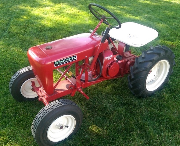

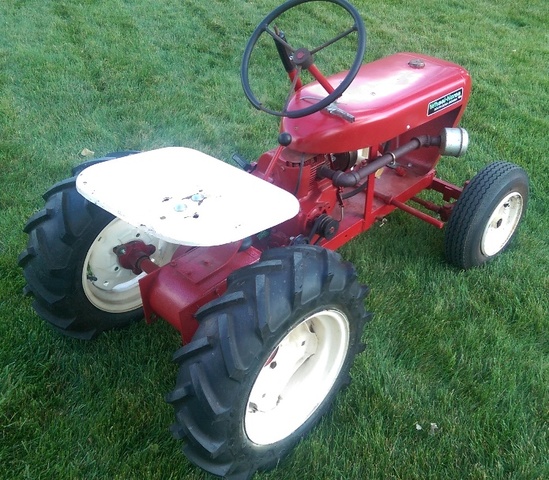

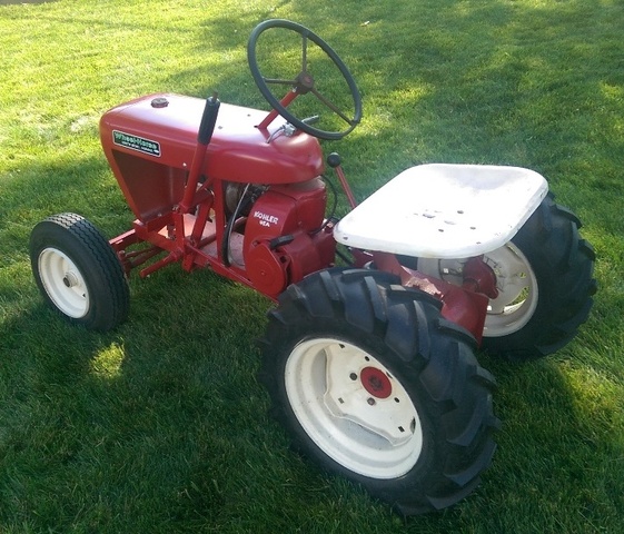

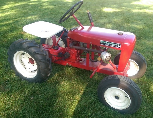

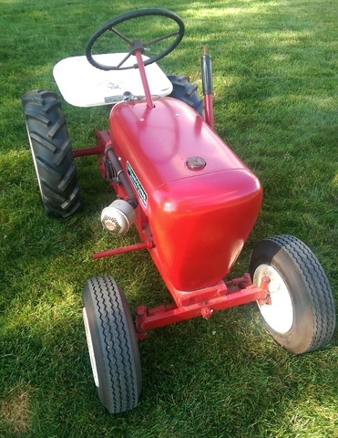

dtoeppe85 22 #1 Posted July 21, 2015 Picked up a RJ35 over the weekend. The guy I bought it from says it's a 1955. It has a K91 engine, that runs pretty good, and has a 5003 transmission. From the little research I've done, I found that the 5003 trans was a dealer installed option. The trans is dated 024-9. The tractor is in decent shape, came with 2 good decks, deck belt cover and a homemade hitch. Needs a few things like a drive belt cover, correct seat, exhaust shield, steering wheel has a chunk of the rubber missing, one hub has an broken tab and uses a through bolt, etc.Right now, I'm having issues with the belt/trans. There is not enough slack in the belt when the pedal is pressed to stop the drive pulley from rotating, thus I cannot shift in to gear. I bought a bit longer belt, but that did not work. Any thoughts on what the issue could be?And as always, here are a few pictures. 4 Share this post Link to post Share on other sites

CasualObserver 3,411 #8 Posted July 22, 2015 You need some belt guides on the engine to create that slack that you're looking for. There are some old topics about them if you search for them. Otherwise I'm sure someone can repost the pictures. Share this post Link to post Share on other sites
