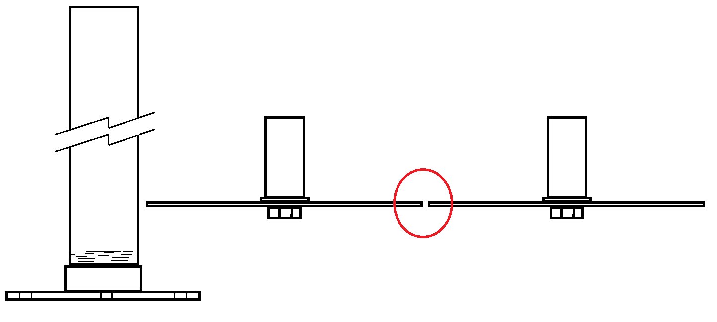

MikesRJ 562 #8 Posted July 27, 2015 (edited) One more thing about quality of cut. I have seen too many decks where the deck shell is bent in the area of the spindles. I have a 3 foot long piece of 2" heavy wall pipe with a large flange screwed to the threaded end. The flange is drilled with the same hole pattern as the deck spindles. Once a year I remove the deck and sharpen blades and check everything (Annual Tune-Up). One of the additional checks I do is to rotate the blades to point at one another. If the difference in tip height between two blades is greater than 1/16" I remove the spindle, bolt the flange pipe to the deck, and bend the deck to correct the miss-match. Bend the deck shell accordingly to make the cutting edges of adjacent blades even with one another. The closer they are to perfect, the better the cut of the deck. Do this for all three spindles and you'll be surprised at how well they cut and the lack of striping in your lawn. Edited July 27, 2015 by MikesRJ 1 Share this post Link to post Share on other sites
