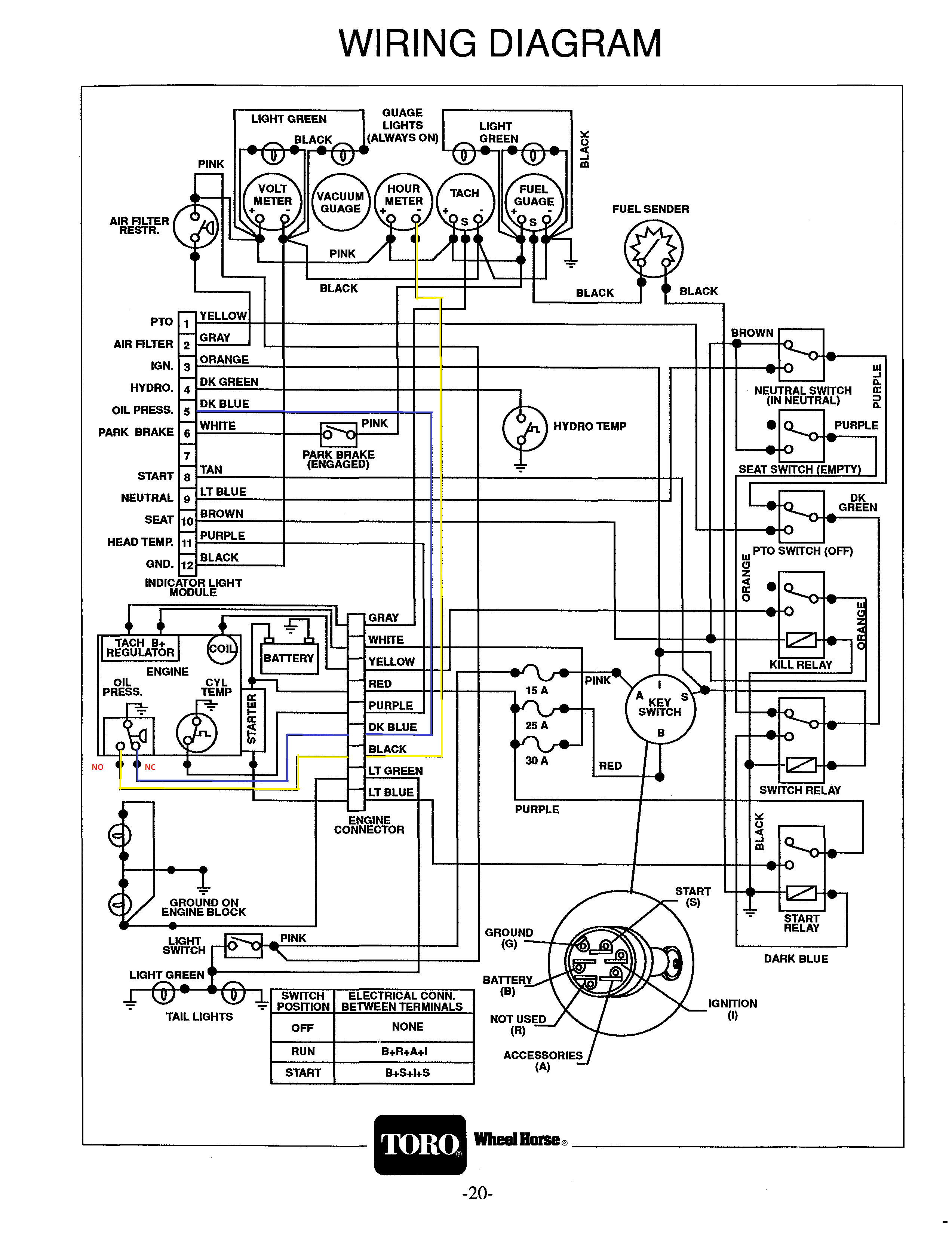

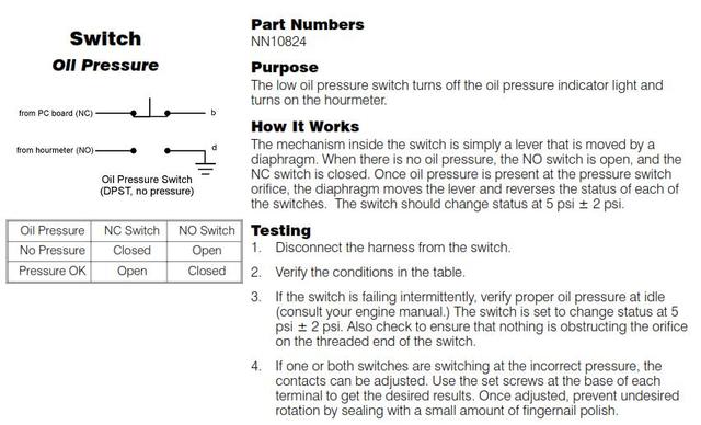

darren 49 #1 Posted July 20, 2015 Evening all! (Or morning, if it isn't) I'm finally getting around to finishing off my 520h rebuild and would be really grateful if somebody could post a picture of the wiring connections on their oil sender? It's difficult to get to, to see because it's behind the tin work but it should have a dark blue and a black wire. Everything's working nicely after the first startup but the oil light's flashing. In pretty sure the sender is double pole and I may have the wires connected the wrong way around but given its the oil I'd like to make sure! Otherwise I'll need to Iaunch into trying to test the sender. If I ground the blue oil sender wire on the chassis, the light goes out so I think the PCB is functioning as it should.. Thank you! Sent from my iPhone using Tapatalk Share this post Link to post Share on other sites
gwest_ca-(File Mod) 11,974 #2 Posted July 20, 2015 Does this help? It is for the NN10824 switch.Garry Share this post Link to post Share on other sites
bmsgaffer 2,069 #3 Posted July 21, 2015 This is from a 91... Hope it helps.Dk Blue = Dark BlueYellow = Black(when you click the diagram to zoom in, there is a button "Full Size" in lower left hand side to view the original size. ) Just noticed you were looking for a picture. Sorry not helpful. Share this post Link to post Share on other sites
darren 49 #4 Posted July 21, 2015 That's okay, they're both helpful. Thanks very much! Sent from my iPhone using Tapatalk Share this post Link to post Share on other sites
