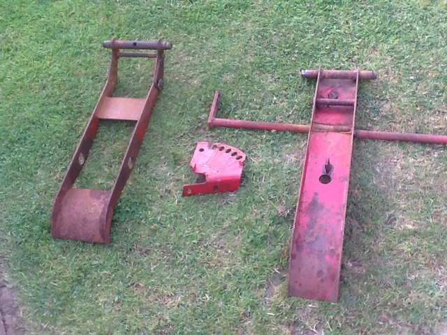

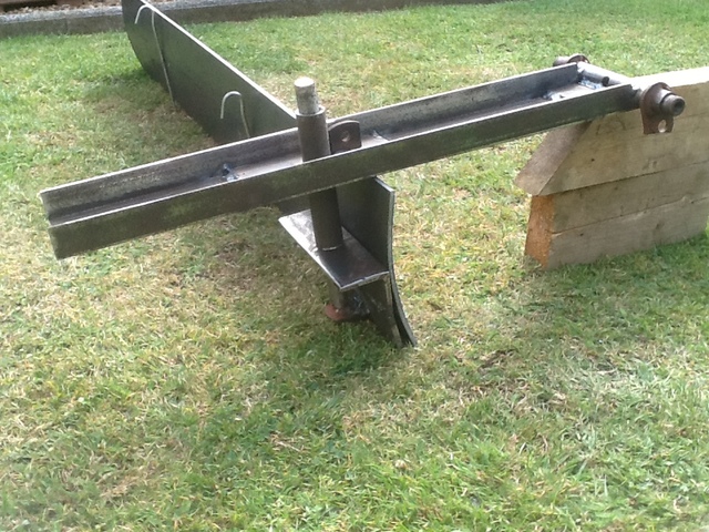

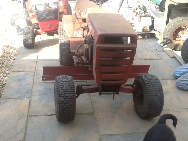

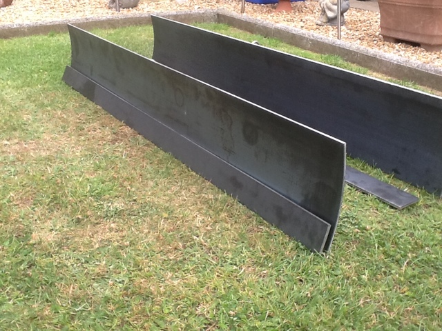

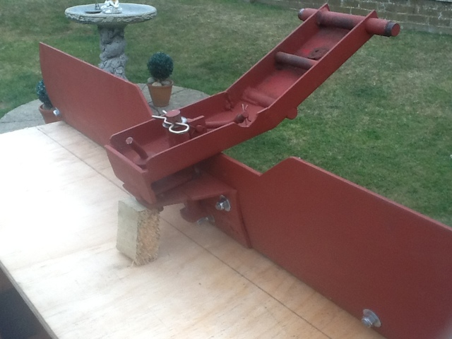

chris sutton 610 #9 Posted December 7, 2016 During August a friend of mine from the north of the country ( Norm ) came down to a couple of southern shows and stay with me for a week so to stop him being bored we decided to have a little challenge and make 2 mid mounted grader blades. it worked out to be 3 days Share this post Link to post Share on other sites

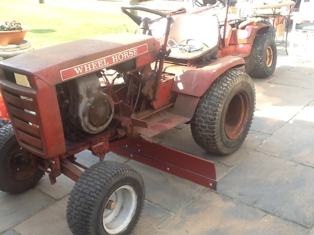

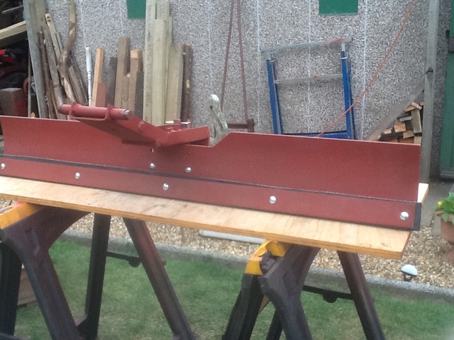

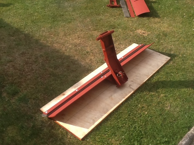

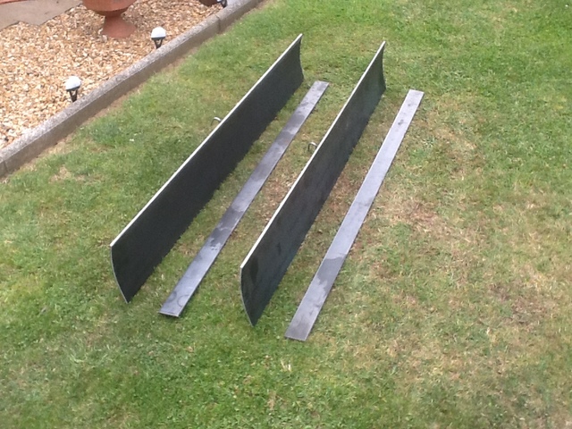

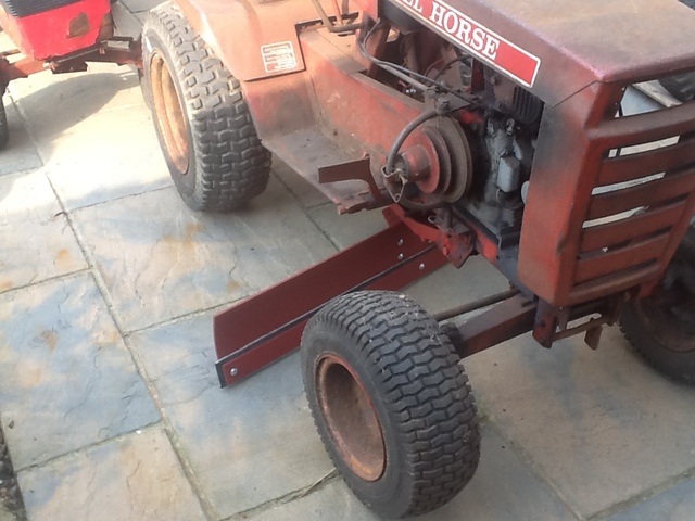

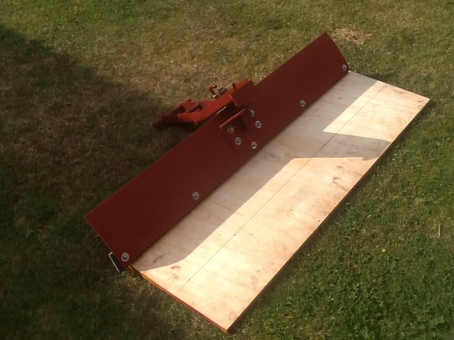

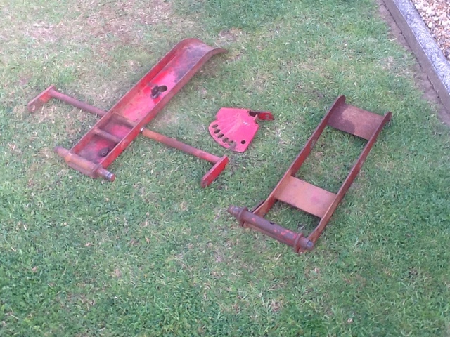

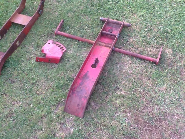

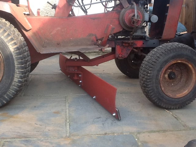

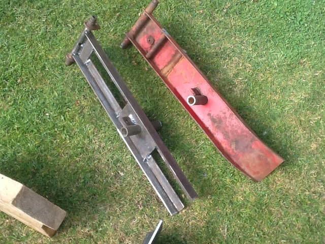

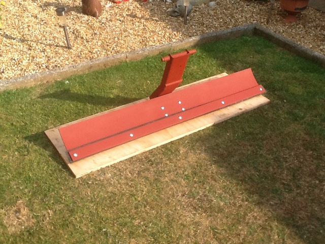

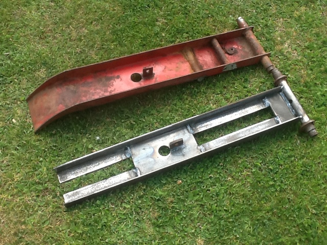

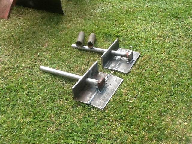

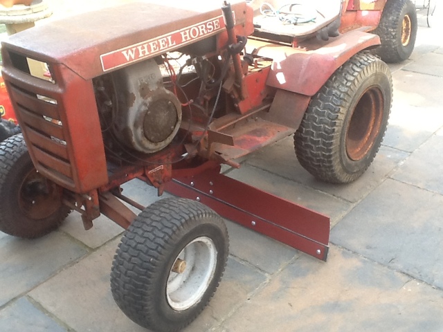

chris sutton 610 #13 Posted December 8, 2016 Materials we used were 2 pieces of 1/4 plate 48" x 7" a few bits of angle iron and rod from the scrap bin and a mounting plate from an old mower deck Heres a few more Just takes a few minutes to fit and first tests were very successful, we can use the blade straight or angle it either way 4 Share this post Link to post Share on other sites

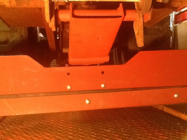

CasualObserver 3,411 #14 Posted December 8, 2016 Excellent job!! Very clean. One view I don't see and am curious of, how did you accomplish your pivot lock and can you adjust it without getting on/off the tractor? Share this post Link to post Share on other sites

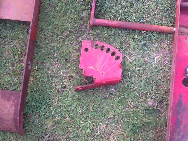

chris sutton 610 #15 Posted December 8, 2016 41 minutes ago, CasualObserver said: Excellent job!! Very clean. One view I don't see and am curious of, how did you accomplish your pivot lock and can you adjust it without getting on/off the tractor? I have to get off the tractor to adjust, it has 3 settings by pulling a pin set the angle required and drop the pin back in. i will do you a photo tomorrow in the daylight Share this post Link to post Share on other sites

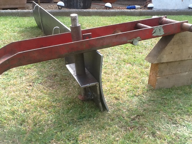

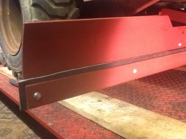

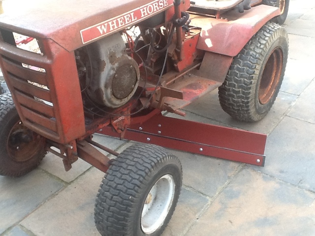

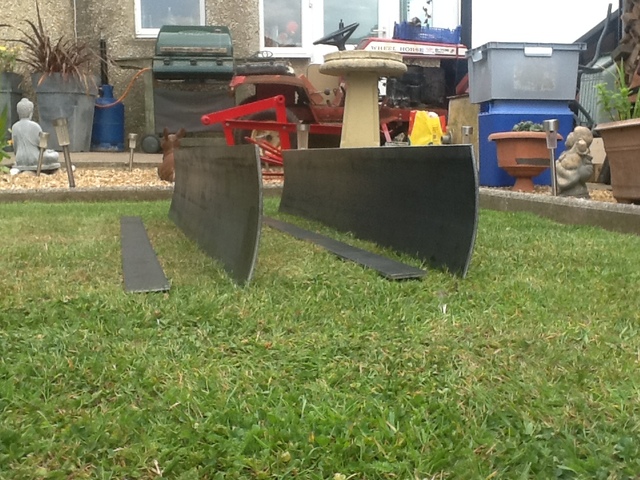

chris sutton 610 #18 Posted December 8, 2016 (edited) The first show we took them to had a working area and trying them out decided that there wasn't enough ground clearance on rough stuff so I did a slight mod to mine and I think Norm did the same. here's a couple more photos Edited December 8, 2016 by chris sutton 1 Share this post Link to post Share on other sites
Stormin 9,986 #19 Posted December 8, 2016 In the third photo' you can see the angle locating pin and one of the locating holes in the bracket, attached to the blade.. Share this post Link to post Share on other sites
obone 142 #20 Posted December 13, 2016 Chris how did you curve your blade? Share this post Link to post Share on other sites
Stormin 9,986 #21 Posted December 13, 2016 (edited) He got a fabricater mate to cut and curve the blades for us. Edited December 13, 2016 by Stormin Share this post Link to post Share on other sites
