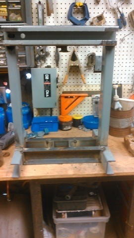

JPWH 6,544 #154 Posted February 28, 2016 (edited) I'm almost ready. I ran out of welding rods but most of it is tacked up. Edited February 28, 2016 by Hank01 Add picture 3 Share this post Link to post Share on other sites
Retired Sparky 526 #155 Posted February 28, 2016 (edited) 27 minutes ago, Hank01 said: I'm almost ready. I ran out of welding rods but most of it is tacked up. That's an awesome looking press. I have no doubt you will win in the end. Edited February 28, 2016 by Retired Sparky 1 Share this post Link to post Share on other sites

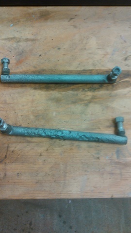

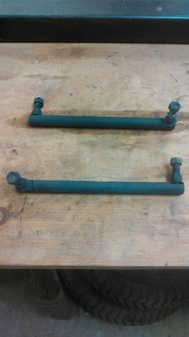

JPWH 6,544 #156 Posted February 28, 2016 (edited) I got the tie rods repaired today. Other than the rust they are in excellent shape so I wanted to use them instead of buying or making new ones. A little mig welding and grinding they came out pretty good. Edited February 28, 2016 by Hank01 Spelling 8 Share this post Link to post Share on other sites
Ed Kennell 46,621 #157 Posted February 28, 2016 A little welding???? That is an awesome job. 3 Share this post Link to post Share on other sites
JERSEYHAWG / Glenn 4,580 #158 Posted February 28, 2016 First class job, as everything has been turning out. Thumbs up. Glenn 3 Share this post Link to post Share on other sites
DennisThornton 4,773 #159 Posted February 28, 2016 2 hours ago, Hank01 said: I got the tie rods repaired today. Other than the rust they are in excellent shape so I wanted to use them instead of buying or making new ones. A little mig welding and grinding they came out pretty good. Holy crap! I'm going to start sending some of my stuff to you! Ya did good, but something you might want to consider next time... Those rust pits, well, craters, really didn't weaken them to where there's a strength issue. You could have filled those with autobody filler, or something like AlumaLead if you wish, sand and finish. I bought a cast vise and was surprised that someone cared enough about it's looks to fill in some voids with autobody filler. Looked great but didn't hold up to some of my pounding! Metal filled epoxies, metal fillers or similar could be used as long as they aren't expected to add strength, just fill the voids. 1 Share this post Link to post Share on other sites

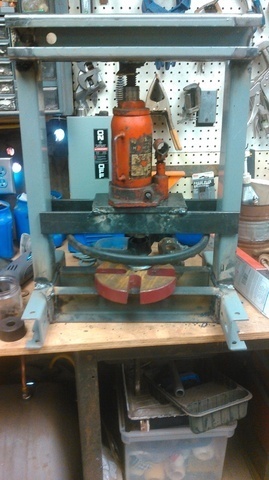

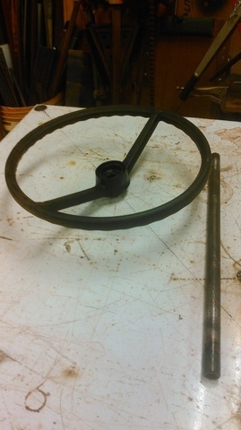

JPWH 6,544 #170 Posted March 6, 2016 The battle of the steering wheel is over. A little drilling, soaking, and about three pumps after contact with my homemade steering wheel press. 9 Share this post Link to post Share on other sites
DennisThornton 4,773 #171 Posted March 6, 2016 I'm pretty sure most of that was accomplished by the third pump! Funny, your first posting had that steering wheel prominently in the middle of the picture. Perhaps your first picture of the "After" will do so as well? One battle after another my friend? I think that's fine as long as you're the winner and I'm sure that's going to continue! "Steering wheel won't come off so he builds a press just for that! Yep! He's going to win!" 3 Share this post Link to post Share on other sites

JPWH 6,544 #175 Posted March 11, 2016 The steering wheel I have was once a chew toy in its life so I figure I could try about anything without damaging a good steering wheel. What I discovered was heat will melt the plastic before it gets the metal hot enough. The plastic becomes soft at about 150 degrees and starts melting about 200 degrees. I think drilling holes at an angle to get penetrating fluid down deep then using a press is the best method for me. I have been working on the damage I caused with the heat as well as the dog teeth impressions. I will say the plastic welder ha sure come in handy. 3 Share this post Link to post Share on other sites
