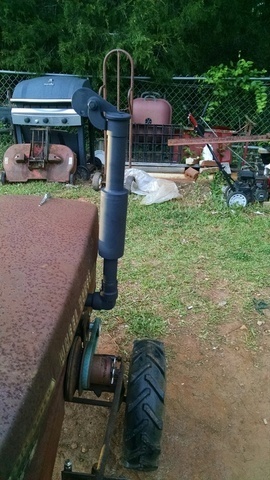

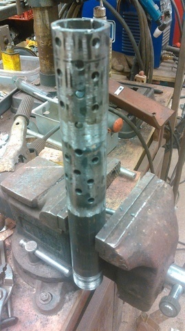

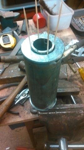

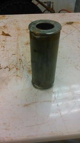

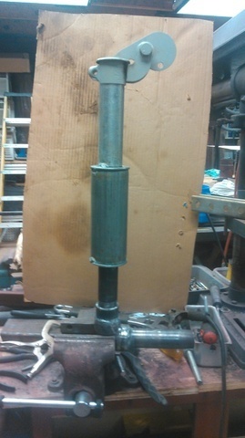

JPWH 6,544 #227 Posted April 7, 2016 (edited) I was going to paint the motor today but mother nature figured we need more rain so I did something else. I want a stack muffler for this tractor but can't seem to find one like I want so I decided to build one. This is how I did it. I cut all the pipe with a tubing cutter. I Bought 2 washers and picked up some scrap sprinkler pipe from one of our jobsites. The larger pipe is a chain link fence pipe. The 90 degree fitting is a weld on fitting a plumber friends gave me. I'll try it on my raider to see if I like the sound and the look. I need to finish welding it up and paint it. Then I will have to figure out a way to support it. Edited April 7, 2016 by JPWH Add pictures and explanation 9 Share this post Link to post Share on other sites

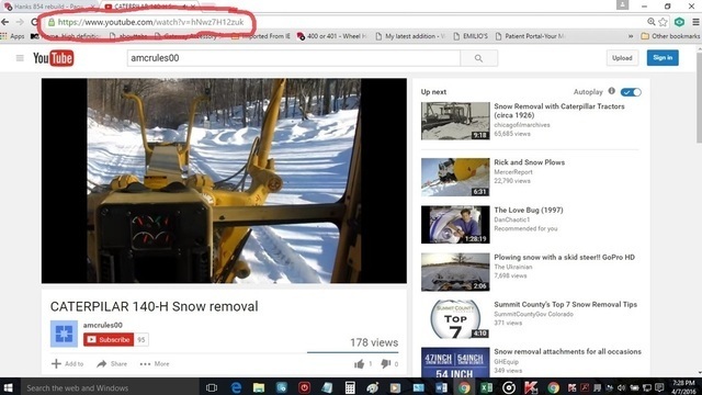

AMC RULES 37,260 #235 Posted April 7, 2016 (edited) Video here is really easy... just sign up for a free Youtube account. Upload your video there, once it's finished... cut and paste the link(URL) into your post here. Edited April 7, 2016 by AMC RULES 1 Share this post Link to post Share on other sites

AMC RULES 37,260 #238 Posted April 7, 2016 For example, cut and paste the red circled link... from your uploaded video...into your post here. 2 Share this post Link to post Share on other sites

JPWH 6,544 #243 Posted April 8, 2016 Now I know I like the way it sounds I'll clean all the welds and paint it and start building another for the 854. Share this post Link to post Share on other sites

JPWH 6,544 #246 Posted April 8, 2016 Got the muffler painted today. 3 Share this post Link to post Share on other sites

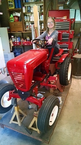

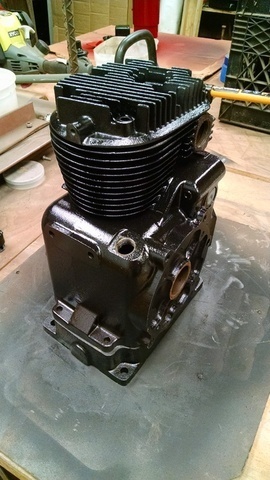

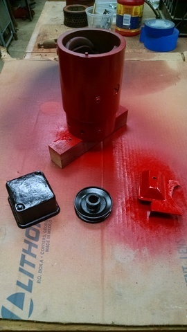

JPWH 6,544 #247 Posted April 10, 2016 Painted the motor and starter/gen along with some tins and other parts. Had a little visitor that wanted to ride so had to reset priorities for a little while. Pepop Ella and of course Charlie had to ride too. 9 Share this post Link to post Share on other sites
