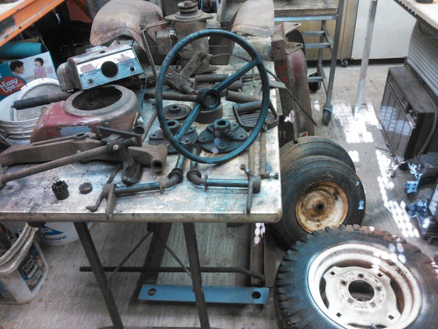

JPWH 6,544 #1 Posted July 18, 2015 The rebuild has officially began. I got the motor unstuck and most of the replacement tins purchased. My son gave me a good set of rear wheels. So far I've had 2 bolts break off. The transmission shifter bolt and one belt guard bolt. I will be needing a left fender, gas cap,lift cable and choke and throttle cables so far. I'm shure a lot more before i'm finished. I can move it around slot easier now but it shure doesn't look like a tractor any more. My wife said it looks like a pile of junk. 10 Share this post Link to post Share on other sites
AMC RULES 37,254 #2 Posted July 18, 2015 I see no junk there...just a labor of love. 5 Share this post Link to post Share on other sites
953 nut 64,474 #3 Posted July 18, 2015 My wife learned a long time ago that the best way to avoid dismay is to not go into my shop. 6 Share this post Link to post Share on other sites
Aldon 4,832 #4 Posted July 18, 2015 (edited) yeah. common reaction from not only the wife but most people with no vision. My GT14 looks pretty similar at the moment. Although I have about 25% blasted and primed. But we know what it will look like when finished and the value of restoring the history.Great job getting it to this point! Edited July 18, 2015 by Aldon 3 Share this post Link to post Share on other sites
MikesRJ 558 #5 Posted July 18, 2015 (edited) Get 'er done! Hope you have a good sand blasting cabinet. I know it'll look great when completed, and you'll be a happy camper. Edited July 18, 2015 by MikesRJ 3 Share this post Link to post Share on other sites
JPWH 6,544 #6 Posted July 19, 2015 Hopefully the blast cabinet will be finished next weekend. My wife learned a long time ago that the best way to avoid dismay is to not go into my shop. You are a brave man. I learned a long time ago to say yes dear. I love you. Then just continue with task at hand. 3 Share this post Link to post Share on other sites

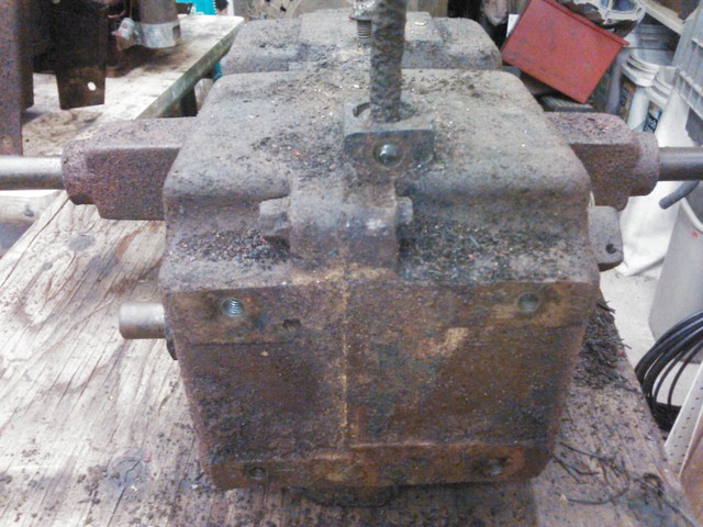

JPWH 6,544 #9 Posted July 21, 2015 Anybody have an easy way to remove the broken shifter bolt shown in the transmission picture above. I'm thinking drill, easy out and heat applied to housing. What have you found to be easiest. Share this post Link to post Share on other sites
ol550 847 #10 Posted July 21, 2015 Anybody have an easy way to remove the broken shifter bolt shown in the transmission picture above. I'm thinking drill, easy out and heat applied to housing. What have you found to be easiest. Easiest way for me has been to weld a washer to the broken part and weld a nut to the washer. Let it cool and back it out. 3 Share this post Link to post Share on other sites
JPWH 6,544 #11 Posted July 21, 2015 Good idea thanks Share this post Link to post Share on other sites

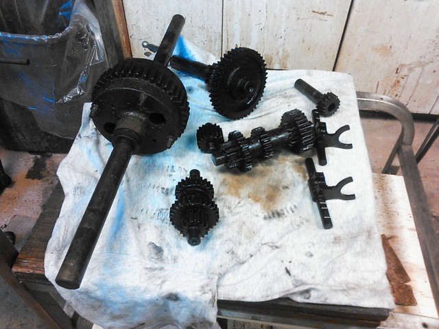

JPWH 6,544 #12 Posted July 25, 2015 (edited) I finally got the transmission apart. What a mess. It appears I will need to find alot of parts. I'll get it cleaned up and see what it really looks like. Can anyone tell what transmission this is. Edited July 25, 2015 by Hank01 2 Share this post Link to post Share on other sites
Racinbob 12,829 #13 Posted July 25, 2015 854's used a 5025 transmission. Section 2 in the manual covers it. 2 Share this post Link to post Share on other sites
oliver2-44 11,275 #14 Posted July 27, 2015 (edited) You might consider blasting everything in that transmission with walnut shells (or fine glass bead) gears, shafts and all. Once its clean those gears may not be to bad, and the shafts might polish up with very fine emery cloth. PS. You mention your blast cabinet is also finished! If you built your own, please share pictures. Edited July 27, 2015 by oliver2-44 2 Share this post Link to post Share on other sites

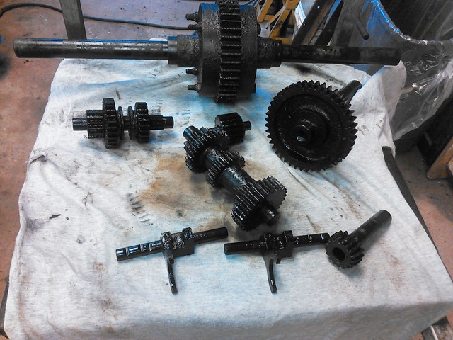

JPWH 6,544 #21 Posted July 29, 2015 I got some more tore down today. It looks like I will need some gearssome are in pretty bad shape. I thought I would let you experts take a look and tell me what you think. Thanks for looking. 2 Share this post Link to post Share on other sites
oliver2-44 11,275 #22 Posted July 29, 2015 I also built a blast cabinet (search for "Blast Cabinet Build" here on red square (sorry I haven't figured out how to copy and paste links) The blast gun and suction metering device I ordered work excellent.Overall I'm happy with it. However there are two things I would change/improve.1. The blast media hangs in the hopper corners, so my slope isn't steep enough. I would use a 60 deg slope if I did it again.2. I have mixed results with the Harbor Freight dust collector. It does a very good job sucking dust out of the cabinet. However some days it seals good, and some days the collector exhaust filter leaks and exhaust dust into my shop. 1 Share this post Link to post Share on other sites
JPWH 6,544 #23 Posted July 29, 2015 Your post gave me the inspiration to build one. I have been collecting metal for a couple of months now. Same metal I built my scrape blade sides from. Its old switchgear enclosures I pick up from jobs. 1 Share this post Link to post Share on other sites
stevebo-(Moderator) 8,604 #24 Posted July 29, 2015 IMO I would not consider rebuilding that rear end. Find a good used one for short money and call it done. 3 Share this post Link to post Share on other sites
Jake Kuhn 1,599 #25 Posted July 29, 2015 Looks like your off to a good start, I also agree that that trans is probably not worth fixing. You can always blast the gears and it will probably work just fine, but probably make some noise. If you do decide you want to get a different trans I have a rebuilt one for sale in the classifieds. 1 Share this post Link to post Share on other sites
