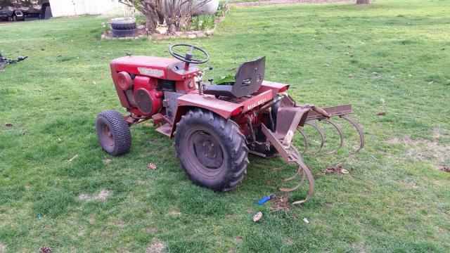

steamdriven23 21 #3 Posted July 18, 2015 Neil, I too ran into that problem when searching for ag tires for my GT14, I finally found skid steer tires that worked in the size 27x8.5x15 mounted on the original GT Rims. So you may want to try searching for skid steer tires, they can be a bit pricey, I finally found a commercial tire dealer who saved me about $60 per tire which put the total at $100/tire. Hope this helps.John Here is what I found and used, brand new 27x8.5x15 4 Share this post Link to post Share on other sites

meadowfield 3,049 #6 Posted July 19, 2015 (edited) I'm on the same 27 8.50-15 skid steer tires. They look good, but at 8 ply the rides a bit rough! Edited July 19, 2015 by meadowfield 4 Share this post Link to post Share on other sites
