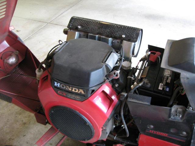

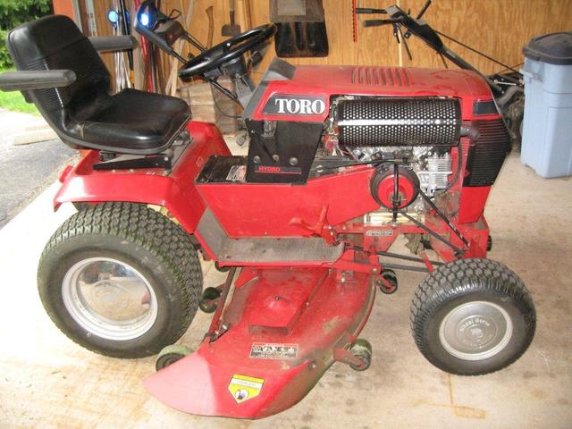

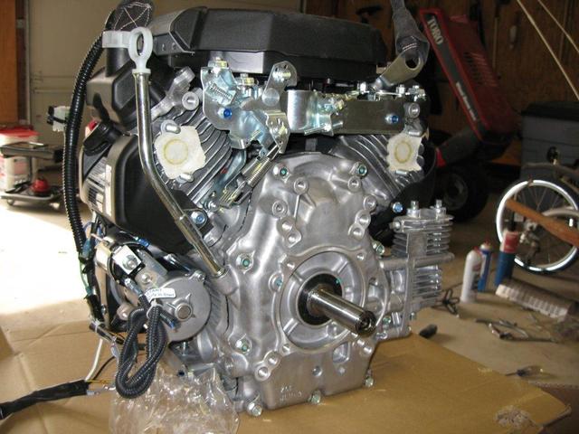

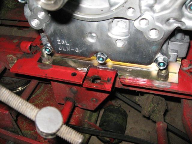

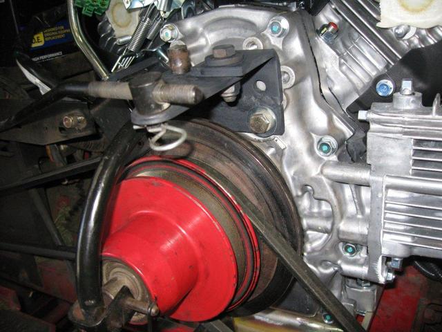

Red-Bovine 337 #45 Posted December 24, 2015 (edited) I did the Honda Conversion a few years ago. It was pricey ($1800.00), but did include all the parts needed to convert like the adapter sleeve and a motor mount. It also included the wiring harness and voltage regulator. The only fabrication was to weld an extension to the clutch bracket to fit the bolt holes on the Honda, similar to what Woodsie needed to do. The HF looks like a good alternative if you don't mind doing a little more fabrication. My conversion was very fast as I did it over a two day period, about 12 hrs. I've been very happy with the conversion. I did not like the supplied muffler and later installed the OEM Honda muffler. It did require cutting into the hood, but it fits better and is quieter. Edited December 24, 2015 by Red-Bovine 7 Share this post Link to post Share on other sites

Red-Bovine 337 #48 Posted February 21, 2017 Can't speak for the HF engine, but the Honda engine is more economical. Not sure exactly how much, but it seems at least 20% better. Red 2 Share this post Link to post Share on other sites
Kurt-NEPA 756 #49 Posted February 21, 2017 1 hour ago, Red-Bovine said: Can't speak for the HF engine, but the Honda engine is more economical. Not sure exactly how much, but it seems at least 20% better. Red Red - how is you Honda doing? I probably have a repower in my near future for my 88 520H. I would really like a Honda, but it sure is hard to justify the price. 1 Share this post Link to post Share on other sites
Red-Bovine 337 #50 Posted February 22, 2017 (edited) It seems to be doing just fine. We use the unit mainly for lawn sweeping, spreading, spraying, and snow blowing since we purchased a Ferris IS2100Z Zero Turn for mowing a couple years ago. The kit we got with the Honda motor from Repower made the conversion very easy. Just the clutch bracket needed a simple extension welded on to bolt it to the motor. Red Edited February 22, 2017 by Red-Bovine 1 Share this post Link to post Share on other sites
