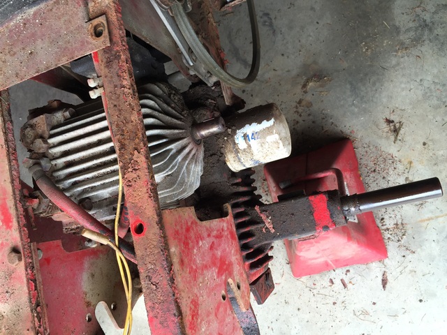

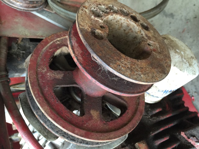

Aldon 4,832 #1 Posted July 14, 2015 Has anyone have experience removing one of these pulleys? This is the one which has double pulley for use with a Rototiller which I will eventually add to my collection once I have the GT14 restored. This pulley is currently on my parts tractor.i located 2 set screws and have them backed all the way out. I don't see anything else that would impede its removal but like every hub or fly wheel or pulley I have had to remove, this does not wish to cooperate. Just looking for some confirmation before I start really putting the leverage to it as I really don't want to damage it. Share this post Link to post Share on other sites
steamdriven23 21 #2 Posted July 14, 2015 From what I remember when I changed out my single pulley for the double you have in the picture, I think since you have the set screws out you may need to soak the shaft the best you can with a PB Blast or some other penetrating oil and carefully use a gear puller on it. If you have the room remove the set screws all together and spray the penetrating oil down into the holes on the shaft. Good Luck! 1 Share this post Link to post Share on other sites
Aldon 4,832 #3 Posted July 14, 2015 Thanks. For some reason I had not yet done that. Might as well skip to the chase though and let it soak for a day or two. 1 Share this post Link to post Share on other sites

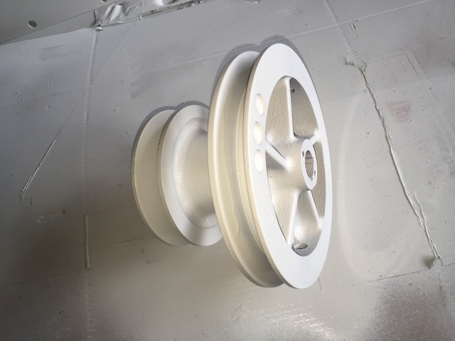

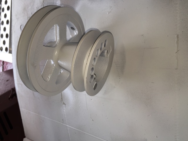

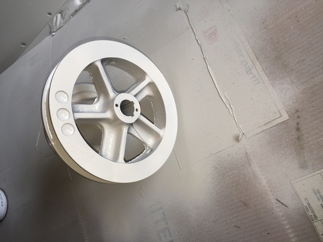

Aldon 4,832 #4 Posted July 18, 2015 Mission accomplished.Already sandblasted and getting a coat of primer. 1 Share this post Link to post Share on other sites
