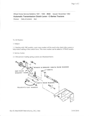

DougC 2,643 #3 Posted December 9, 2015 I came across this thread and have an 88 520 also with a belt that seems to flop a bit and a belt disengage lever with no knob that rattles and jumps around until you hold onto it and then things quiet down. I have a 95 520 that does not have this lever so I am not familier with how to use it, why to use it and how much noise and movement is normal for these to make. Since we already have a picture above of lever 49 can knobs still be bought for these and what is the procedure for using the disengage. This is my next project as I have now repaired the charging system and tachometer thanks to the help of forum members. Share this post Link to post Share on other sites

MalMac 1,334 #5 Posted December 10, 2015 Here's a service bulletin on correcting the rattle of the disconnect. Not really has anything to do with belt routing though. 1 Share this post Link to post Share on other sites
