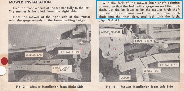

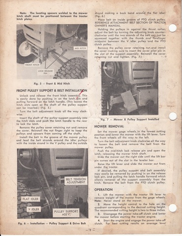

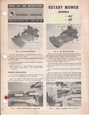

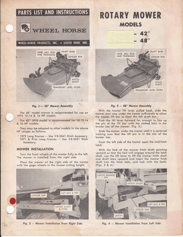

daveoman1966 3,881 #2 Posted July 10, 2015 1.) The PTO-to-Deck belt has to be on the INNER-MOST 'V' of the PTO pulley...that is, the V closest to the engine. 2.) Use only the OEM belt (s/b 102742) The aftermarket belts do not EXACTLY match the contour of the Wheelhorse V pulleys leading to drag & premature failure3.) Either straighten that pulley, or replace it. (I have replacement pulley7s for 42 or 48 " decks).4.) Check BOTH of the idler pulleys on the MULE DRIVE. If either one drags at all, or wobbles more than little, replace it (I have those too).5.) Are you CERTAIN that the deck is hung correctly? There is a right and a wrong way to hang it. Check with the DECK manuals on-line in this forum. 3 Share this post Link to post Share on other sites

mancanic2 4 #6 Posted July 12, 2015 Dave,Been looking for the pages you have listed on here, would be a great help if you could lead me to them. I think it might be installed wrong, I am using a Wheel horse belt but maybe the wrong size. will let every one know thanks for the help Share this post Link to post Share on other sites
mancanic2 4 #7 Posted July 13, 2015 Found the problem... belt was installed improperly and also there was an improperly installed bolt and or bushing missing on lift arm. after replacing and double checking everything works great! 1 Share this post Link to post Share on other sites
