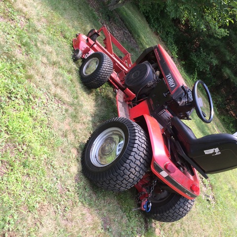

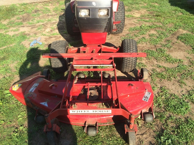

muz123 1,193 #1 Posted July 8, 2015 I recently picked up a front mower from the big show. I got it for a whopping $90!. It works great under trees and bushes. Took me quite a while to find one. Here are some pictures after getting it hooked up. 4 Share this post Link to post Share on other sites

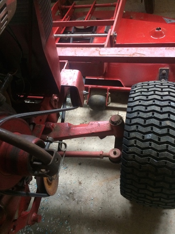

Ed Kennell 43,832 #4 Posted July 8, 2015 Got any pics of the drive belt arrangement? 2 Share this post Link to post Share on other sites
pacer 3,177 #5 Posted July 8, 2015 Them things are tooooo cool!! 1 Share this post Link to post Share on other sites
PaulC 342 #6 Posted July 8, 2015 This is a very neat setup and ive always wondered the point but you mentioning getting under trees and what not with it makes sense. Whats it like for actual mowing? Id guess not to much different. Ive always thought id like to get a front mount reel mower but I don't think they made them past the 70's or so.$90 bucks seems like a great price. It was just the mounting brackets and hardware right, not the deck too? Can you mount any standard attach-a-matic deck to it? Man would it look cool with a 60" under it 1 Share this post Link to post Share on other sites
JC 1965 1,534 #7 Posted July 8, 2015 First time I've seen one mounted on a tractor. It looks really good. 1 Share this post Link to post Share on other sites
ba2988 28 #8 Posted July 8, 2015 I have the same front mount carrier and used it for a few years with a 48 inch deck. It worked well - my only complaints would be that you get some blow back of grass clippings in your face especially if there is wind. Also, standard deck wheels will dig into the grass in a sharp turn - I put some larger more rounded wheels on my deck to help limit this issue. The carrier does come with 2 rods with smaller wheels that bolt to the flat bar (nearest to the tractor) but these are essentially useless. What it really needs are 2 additional wheels that are beefy like the 2 swivel casters in the front. Another benefit is that it is much easier to take on and off than the standard belly mount.Brice 3 Share this post Link to post Share on other sites
muz123 1,193 #9 Posted July 9, 2015 Got any pics of the drive belt arrangement? I will try and get some up tomorrow. 1 Share this post Link to post Share on other sites
muz123 1,193 #10 Posted July 9, 2015 (edited) This is a very neat setup and ive always wondered the point but you mentioning getting under trees and what not with it makes sense. Whats it like for actual mowing? Id guess not to much different. Ive always thought id like to get a front mount reel mower but I don't think they made them past the 70's or so.$90 bucks seems like a great price. It was just the mounting brackets and hardware right, not the deck too? Can you mount any standard attach-a-matic deck to it? Man would it look cool with a 60" under it Yes, it was just the mounting brackets and the hardware. Also you can mount any attach-a-matic deck onto it. The deck i got separate. Edited July 9, 2015 by muz123 Share this post Link to post Share on other sites
can whlvr 994 #11 Posted July 9, 2015 I too have wondered how the belt works,a mule drive from thr middle attachmatic ? 1 Share this post Link to post Share on other sites
ericj 1,579 #12 Posted July 9, 2015 there is suppose to be an idler that goes into the center quick attach, looks very similar to the tiller idler but i believe it only has 1 pulley on it. actually the axle going through the belt and it takes a special belt if i recall correctly.eric j 1 Share this post Link to post Share on other sites
muz123 1,193 #13 Posted July 9, 2015 (edited) there is suppose to be an idler that goes into the center quick attach, looks very similar to the tiller idler but i believe it only has 1 pulley on it. actually the axle going through the belt and it takes a special belt if i recall correctly.eric j Yes you are right. One part of the belt goes under the front right side of the axel and the other part of the belt goes on top of the axel. So you would have to jack up the front wheel to get the belt on. Edited July 9, 2015 by muz123 Share this post Link to post Share on other sites
boovuc 1,090 #14 Posted July 9, 2015 I thought this would be a good setup for those of us who have high grass that doesn't need mowed all the time. High grass/weeds get smashed down by the wheels but not so with a front-mount deck that is wider than the wheelbase of the tractor. I always wanted to try one but bulked at the costs of the carrier. You got a nice deal at the show! Congrats! 1 Share this post Link to post Share on other sites

muz123 1,193 #17 Posted July 9, 2015 Got any pics of the drive belt arrangement? here is the belt arrangement. 2 Share this post Link to post Share on other sites
Lane Ranger 11,681 #18 Posted July 9, 2015 (edited) Thanks for posting these pics. I bought a front carrier for $40 at an auction but did not get the idler piece that goes under the PTO in the attach- a- matic. If you get a chance when the mowing season is over post some dimensions on the idler setup. Looks like it would work great on taller grass except for the wind blown grass as mentioned above that might happen every once in a while! Edited July 9, 2015 by Lane Ranger 1 Share this post Link to post Share on other sites
Ed Kennell 43,832 #19 Posted July 13, 2015 Very interesting belt arrangement. Thanks for the pic Muz. Is the pulley under the PTO a spring loaded tensioner? 1 Share this post Link to post Share on other sites
muz123 1,193 #20 Posted July 15, 2015 (edited) Very interesting belt arrangement. Thanks for the pic Muz. Is the pulley under the PTO a spring loaded tensioner? Yes it's spring loaded. The spring attaches to the holes on the right side of the engine mount. Edited July 15, 2015 by muz123 Share this post Link to post Share on other sites
