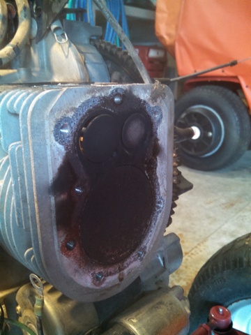

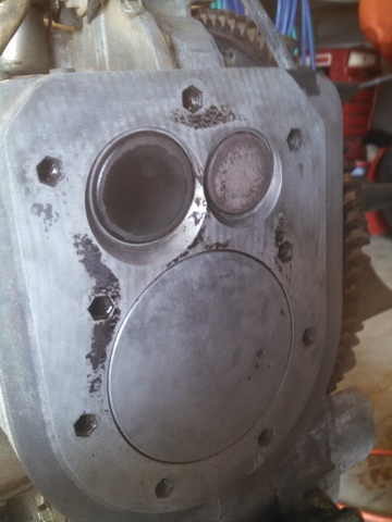

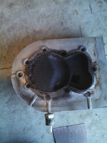

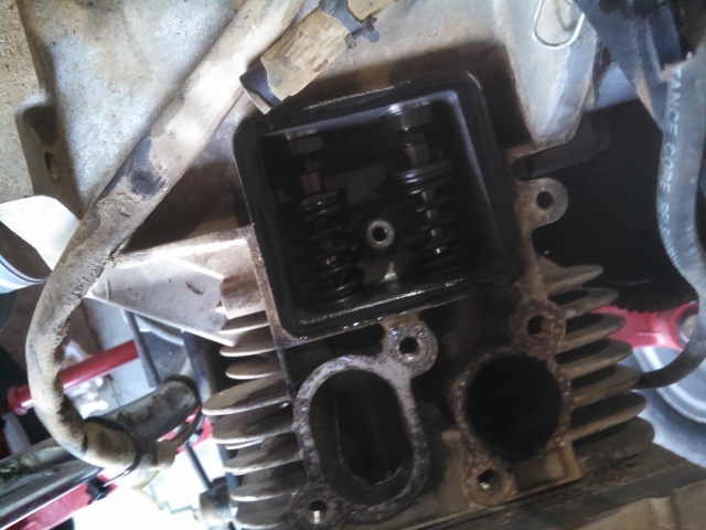

I want to adjust the valves on my 520H. When checking gauge 5000ths intake and 13000ths exhaust. Is this correct? Do I check the clearance by when the black nut is about to spin against the rod? What do I use to clean the top of the piston and cylinder head? Is there anything else that I need to do since it's apart? I cleaned the carburetor.

Oven cleaner works good to clean heads.I have used Super Clean purple with good results as well.Not sure about the piston tops other than light scraping.

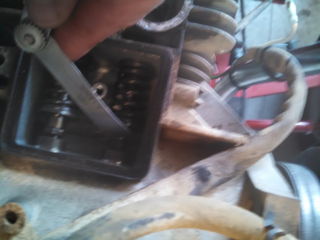

I just adjusted the valves on my 520H.  .005" and .013" is correct.  There is a adjustment procedure in the Onan manual, but I usually just rotate the engine until the valve is closed.  Then watch the lifter until it is fully retracted.  Then I adjust the intake tappet until the the .005" feeler enters and the .006" does not.  I rotate the engine and check it several times.  Repeat with .013"/.014" feelers on the exhaust tappet.  I would love to do this with the engine running like I would do on a car, but you can't do that on this engine.
For cleaning the head, I use Carb and Choke cleaner with a plastic or brass brush.  It cuts most of the residue.  I polish things with a ro-loc scotch brite pad in a die grinder.  Just don't get carried away.  No sharp steel tools.

608KEB

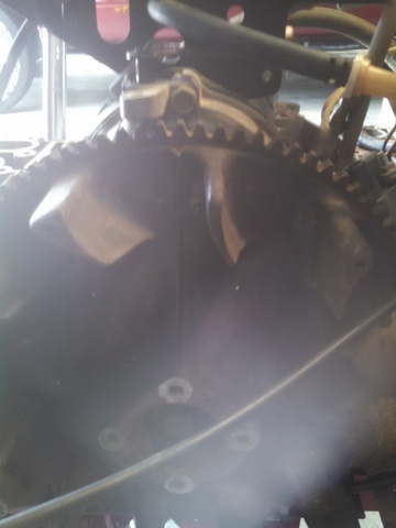

I rotated flywheel to top dead center. Both valves are closed. I can't fit feeler gauge  between tapet and rod. So I'm guessing it is to tight.
608KEB

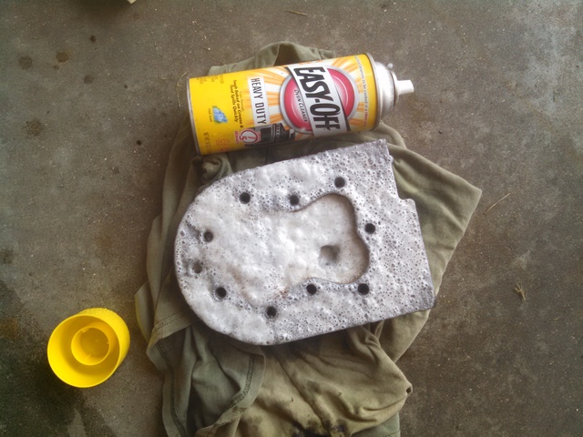

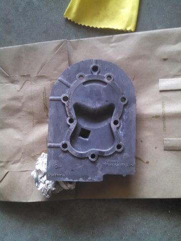

Cleaned up well with Easy Off.
Kurt-NEPA
Looking good!
