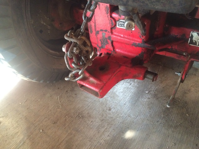

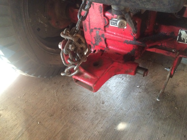

muz123 1,193 #1 Posted June 20, 2015 (edited) I just put my slot hitch on my 520-H after ten years and don't know what attachments i can use on it. What attachments can i put on it and use? Thanks, Dave Edited June 20, 2015 by muz123 Share this post Link to post Share on other sites
slammer302 2,157 #2 Posted June 20, 2015 (edited) the slot hitch works with alot of the older attachments i have a wheel horse disc that uses that style hitch and ive seen older single bottom plows that use it too. you would need the sleeve hitch for most stuff thats sold these days Edited June 20, 2015 by slammer302 1 Share this post Link to post Share on other sites
squonk 45,591 #3 Posted June 20, 2015 Just get or make a slot hitch to sleeve hitch adapter and you can use almost anything. 1 Share this post Link to post Share on other sites
Racinbob 12,802 #4 Posted June 20, 2015 Easy enough to make or one of the venders here sells them. 1 Share this post Link to post Share on other sites
muz123 1,193 #5 Posted June 20, 2015 (edited) I was thinking about buying a clevis hitch off of wheelhorseman1000 at the wheel horse show. Edited June 20, 2015 by muz123 Share this post Link to post Share on other sites
