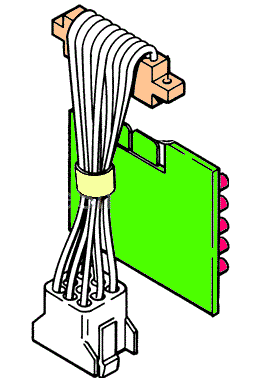

wrightorchid 261 #1 Posted June 19, 2015 Is there a reasonable test switch for the PC board? The toro part 116796 runs from $38 to $45, which seems very high for a tiny button.1991 312-8 with M12. Share this post Link to post Share on other sites

Save Old Iron 1,571 #4 Posted June 19, 2015 (edited) Do you have a 9 pin connector wired into the circuit board?Is there a gray wire in the 9 pin harness?If so, connecting 12 volts to the grey wire should simulate the test switch function and light all the indicators.. Edited June 20, 2015 by Save Old Iron Share this post Link to post Share on other sites
