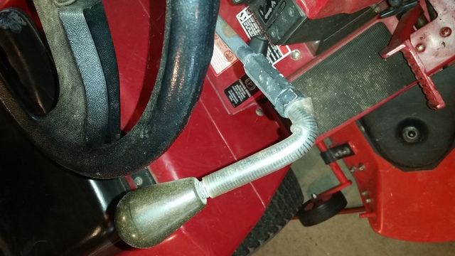

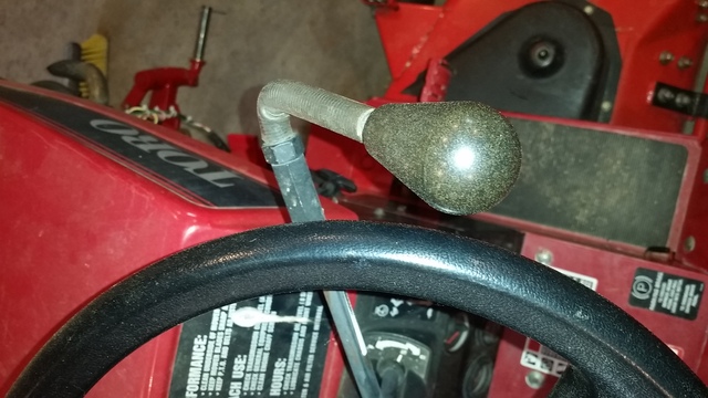

WHX?? 53,723 #5 Posted June 18, 2015 Lube the shaft where the spring rides ... I used some spray lithium grease , and check the linkages. I'll take & post some pics of what i did for that annoying under the wheel shift, real easy and alot better till you score a foot kit. 1 Share this post Link to post Share on other sites

WHX?? 53,723 #7 Posted June 18, 2015 Material list is real extensive for this...12" piece of 1/2" threaded rod1/2" threaded rod coupling1/2 nutshort piece of tubeing 1/2" id optionalPuts the DCL knob right up by the rim of the wheel so you don't have to take your hands off the wheel to operate.I heated the rod up to get that bend in itI slid the tube on just to protect my delicate hands from the edges of the rodnext best thing than a foot control Share this post Link to post Share on other sites
