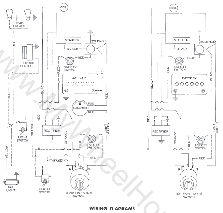

MikesRJ 559 #1 Posted June 14, 2015 (edited) I know this topic was covered several times before, but I searched the forum for about an hour and cannot find any of the old posts. Here's my dilemma.Since the local mice really liked the taste of my '73 10-8 wiring harness, and I pretty much have to fabricate an entirely new one, I'd like to add a connector for a trickle charge connection. I seem to remember hearing there was an issue as to where to actually make the charging connection, as doing so incorrectly caused a feedback loop to the regulator, which could damage the $50-$75 regulator. I suspect there was an addition of a diode somewhere to prevent this loop, but like I said, I cannot find any of the old posts. Any help would be greatly appreciated. Edited June 14, 2015 by MikesRJ 1 Share this post Link to post Share on other sites
oldredrider 2,553 #2 Posted June 14, 2015 After a quick look at the wiring diagram, as long as the key switch is OFF, there should be no loop to the regulator. Share this post Link to post Share on other sites
MikesRJ 559 #3 Posted June 15, 2015 Agreed. I just seem to remember there being a safety issue and someone posted a fix for it. I was originally just going to add two wires to the battery terminals and run them to a connector off the side of the machine, then I got to thinking about it (a scary thing, mind you). 1 Share this post Link to post Share on other sites
bmsgaffer 2,069 #4 Posted June 17, 2015 I haven't been on here as long, but I don't recall hearing of any safety issues with trickle chargers.With the Key off there is no issue, and even with the key on the rectifier/regulator has diodes inside of it, you wont blow it up with a trickle charger. If you could then anytime anyone ever jump started a tractor they would blow up their regulator, which doesn't happen. And anyway if you did leave the key on you'd have a bigger problem by possibly blowing up the coil!Just red to (+) and black to (-) and you'll be good to go! 1 Share this post Link to post Share on other sites
JC 1965 1,545 #5 Posted June 17, 2015 I agree with Brandon, I've been using a battery tender for several years on my tractor that I use to push snow. It stays on charge anytime that the tractor is not in use. I have had no problems with it. I always make sure that I remove the key from the ignition switch so I don't accidentally leave the switch in the on position. I left the key in the on position on another tractor several years ago and fried the coil. 1 Share this post Link to post Share on other sites
