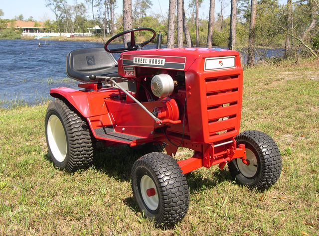

Racinbob 13,122 #35 Posted June 17, 2015 There's no question that using a gun is better but you'd be amazed at the quality of a rattle can job if done properly and conditions are just right. This Commando doesn't look like this anymore but it has held up better than I expected considering it's been used hard by my grandson. I'm sure a gun job with hardener would have held up better though. 2 Share this post Link to post Share on other sites

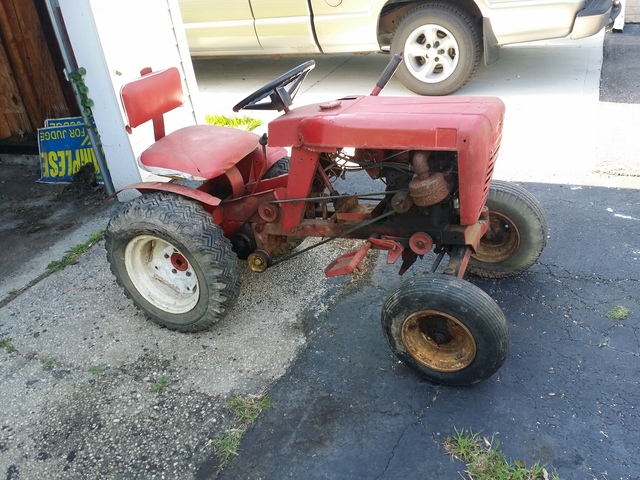

JamesC-120 204 #42 Posted July 10, 2015 I got everything painted and ready to go(except a few small parts are not done yet). I just need 1 more coat of paint on the fenders and hood and we will be in good shape. Transmission is going back together tomorrow and a few other things. I got some amazing lug tires off ebay. They are Carlisle farm specialists 6-12 and the lugs are huge(1" tall). And they are quite thick at 6 ply. Also got some tri rib tires for the front. I ended up using rustoleum farm equipment paint in the quart can and bought some majic paint hardener and they work amazing together. The paint gets extremely hard in just 1 night. Here's a few pics! 8 Share this post Link to post Share on other sites
RedRanger 1,470 #43 Posted July 10, 2015 So you used an enamel with hardner? Looks good. Share this post Link to post Share on other sites

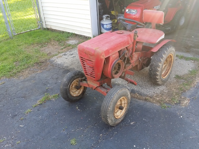

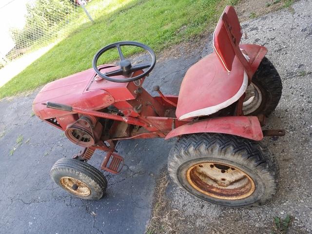

Ohiocop 7 #45 Posted July 11, 2015 (edited) Just bought this wheel horse anyone tell me anything about it. It runs and drives has a plow but no mower deck, needs a new rear tire other than that it's in great shape, planning on using it to plow my driveway with Edited July 11, 2015 by Ohiocop Message edit 3 Share this post Link to post Share on other sites
MikesRJ 563 #46 Posted July 12, 2015 (edited) '62-'66 700 series tractor. Depends on a few additional details. Engine model and spec numbers (if original), which tranny, and a few other details. You really should start a separate thread and not hijack this one going off on a tangent. :) Edited July 12, 2015 by MikesRJ Share this post Link to post Share on other sites
