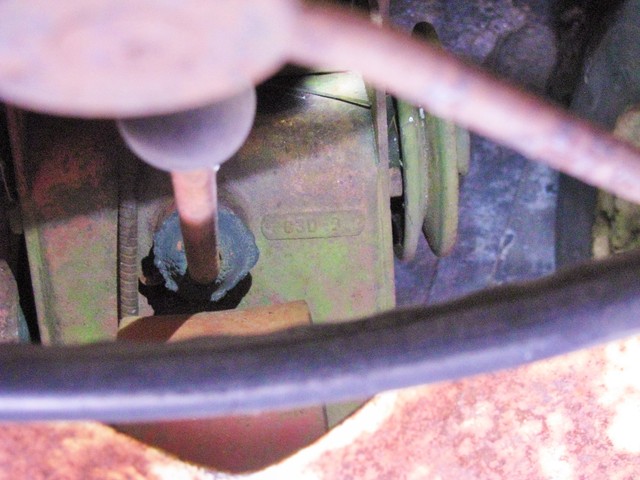

Should be a code, cast on top of the trans, right side...next to the shifter.
What's your number?

The top of the transmission says A27-9. Already tor down the trans and found a lot of sludge and water but everything seems good except a few bearings. And if it helps at all the transmission has the ball bearing in it not the needle bearings.

They say the 9's are rarer than the 8's.

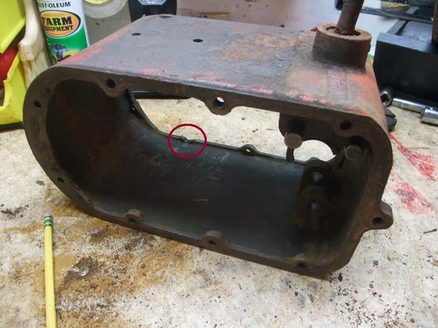

I do believe I'm seeing an issue with your case James. On the bottom left side the rear 'ear' where the sideplate bolt goes is snapped off.
  • Like 1

RacinBob...his casting is alright...it is showing all 9 bolts.  It just looks like something should be there...believe it is just sludge.  :)
C-101plowerpower
you sure Dino? it does really look like there is something missing
Racinbob
Funny Koen. I just did the same thing.
stevasaurus
Dang...I was looking at this side of the casting.  Good eye guys...I totally missed that one.  I guess I am still starry eyed from the Blackhawks game last night.
