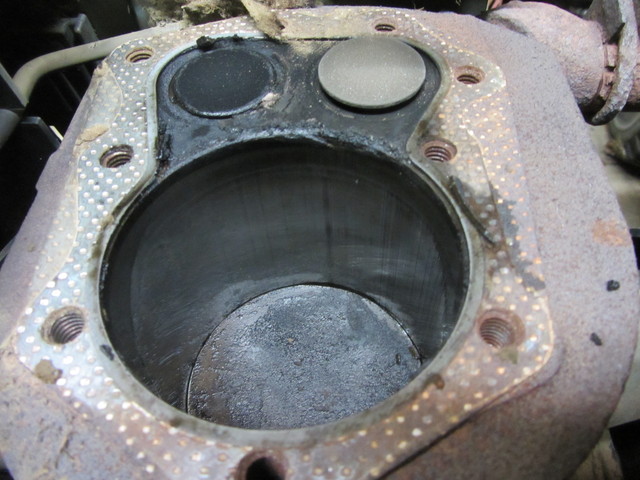

Fordiesel69
You can get 2000 ~ 2500 hrs if you run a diesel oil, changed often.  No longer does SM or SN oils have proper additives for flat tappet cams.  Diesel oils do.
So Shell Rotella T1 SAE 30, Mobil Delvac SAE 30, and Valvoline & chevron makes some.
During the winter Shell has a 10w-30 diesel oil.
-Warm up engine at 50 - 60% throttle, NEVER EVER at idle.  The dipper will never sling the oil to the cylinder, and you will create an oil burner in very short order.
-Operate at 100% full throttle during hot days so you get proper airflow.  Regardless of internet rumors you can operate a little slower when you are not loading it down much & overheating it.  But if you are mowing, run it wide open.
-Regardless of oil type, never ever extend the oil change beyond 25hrs.  These engines shred metal, and there is no way to filter it.
-Fix & repair the throttle shaft busings in the carburetor.  These will loosen up around 700-800 hrs on a Walbro carb.  This is an instant source of dirt entering the cylinder.
-Inspect every year the rubber hose going from the carb to the crankcase breather, these dry rot, or fall apart and also let lots of dirt in.
-Make sure to decarbon the cylinder ridge, this will eat the piston alive.  Attached is one that was never done.  It is now in need of a rebuild.  This needs done every 250-500 hrs.  I prefer to do it at 250 as you never know how bad it is until you look.  If done at 250 you can reuse the headgasket.  At 500 you should replace.
  • Like 3
