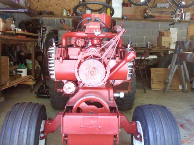

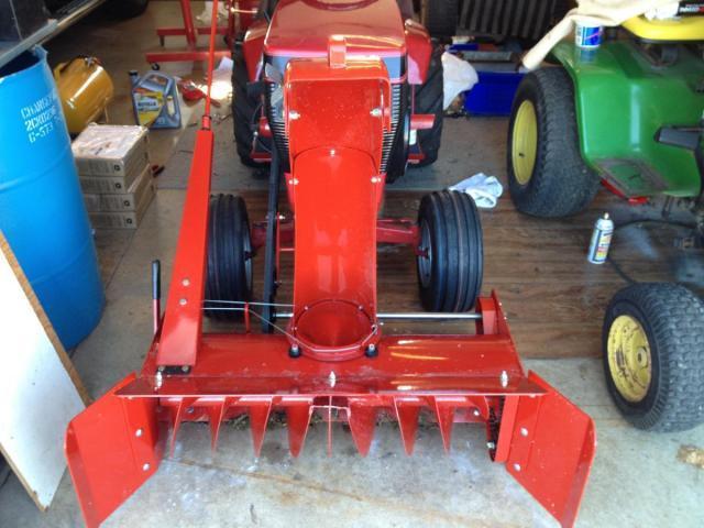

Martin 2,134 #7 Posted June 15, 2015 The smaller size (16 x 6.50-8) works better with the standard wh front wheels (5.38 wide x 8). over on the JD forum (weekendfreedommachines.com) they talk about the two widths of the v61 tires and their suitability for wheel sizes. general opinion is the 16 x 6.5-8 works with the common 5.38 width and the 18 x 8.50-8 is better suited to the wider JD wheel on the bigger tractors (i think its 7 inch but not positive). as mentioned above the d series Wheelhorses use a wider front wheel. the key for proper fitment is to look at the sidewall profile from the front. those wider tires look right with the wheels on that d pic above this post.here is a pic with the smaller size on smaller 5.38 wheels (400 series) on my 416....sidewalls look similar on both, in my opinion both of these pics show proper wheel/tire sizing. 3 Share this post Link to post Share on other sites
RedRanger 1,470 #8 Posted June 16, 2015 The smaller size (16 x 6.50-8) works better with the standard wh front wheels (5.38 wide x 8). over on the JD forum (weekendfreedommachines.com) they talk about the two widths of the v61 tires and their suitability for wheel sizes. general opinion is the 16 x 6.5-8 works with the common 5.38 width and the 18 x 8.50-8 is better suited to the wider JD wheel on the bigger tractors (i think its 7 inch but not positive). as mentioned above the d series Wheelhorses use a wider front wheel. the key for proper fitment is to look at the sidewall profile from the front. those wider tires look right with the wheels on that d pic above this post.here is a pic with the smaller size on smaller 5.38 wheels (400 series) on my 416....sidewalls look similar on both, in my opinion both of these pics show proper wheel/tire sizing. What Martin said. Rim width is the deciding factor on tire size. The 8.50 tires need a wider rim than the 6.50.So the question is, what size rims do you have? 1 Share this post Link to post Share on other sites
