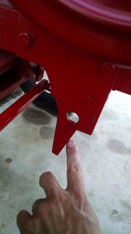

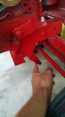

slammer302 2,156 #3 Posted June 14, 2015 their will be a rod in the middle of the deck remove it to Share this post Link to post Share on other sites
stratostar250 934 #4 Posted June 14, 2015 And there should be a cotter pin holding a lift bar from the deck to the lift itself, but that's it. Turn the wheels, and drag it out from under. I'm pretty sure that's it! Share this post Link to post Share on other sites
stevasaurus 23,534 #5 Posted June 14, 2015 (edited) Take the belt off the pulleys 1st...then release the front attachamatic...then lower the deck and use the star wheel to get slack to the lift arm and pull the carter, or hair pin from the lift arm. Jack up the front of the horse and turn the steering wheel to the right...slide the deck out. Works every time. To re-install...do reverse order. The MANUAL for installing and taking off the deck is in the reference section. Nice pictures Slammer !! Edited June 14, 2015 by stevasaurus 3 Share this post Link to post Share on other sites
squonk 45,062 #6 Posted June 14, 2015 Take the belt off the pulleys 1st...then release the front attachamatic...then lower the deck and use the star wheel to get slack to the lift arm and pull the carter, or hair pin from the lift arm. Jack up the front of the horse and turn the steering wheel to the right...slide the deck out. Works every time. To re-install...do reverse order. The MANUAL for installing and taking off the deck is in the reference section. Nice pictures Slammer !! Steve you forgot; turn off the engine first! In all seriousness you don't know how many times I've been in a hurry and left the belt on. Only to release the front hitch and now I have a mower deck just dangling by the belt! 1 Share this post Link to post Share on other sites
