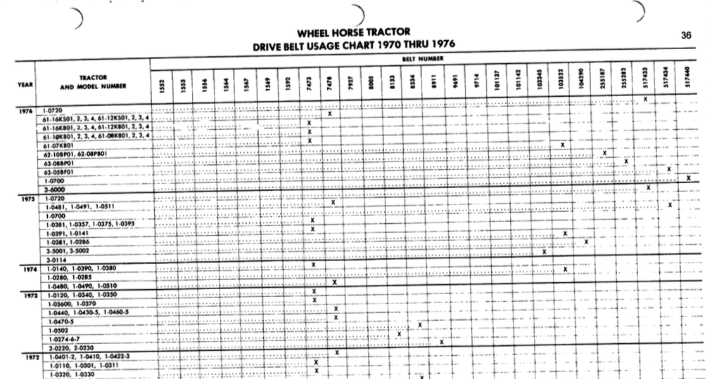

WNYPCRepair 1,924 #3 Posted June 14, 2015 (edited) Maybe this will help Edited June 14, 2015 by WNYPCRepair 1 Share this post Link to post Share on other sites
daveoman1966 3,882 #4 Posted June 14, 2015 1975 C-160 Auto takes belt # 7478 at 84" . The 8-speed manual takes belt # 7473 at 82". Thats per the Toro website.I have several of the GOOD USED belts in my shop. They aren't stretched or slashed, cut or chunks out of them..For more details if you want to buy one of mine, send me a direct emails....clik here:daveoman@windstream.net 1 Share this post Link to post Share on other sites
squonk 45,590 #5 Posted June 14, 2015 Napa 5L820W I have run that belt on my 76 for 5 years with no issues 1 Share this post Link to post Share on other sites
