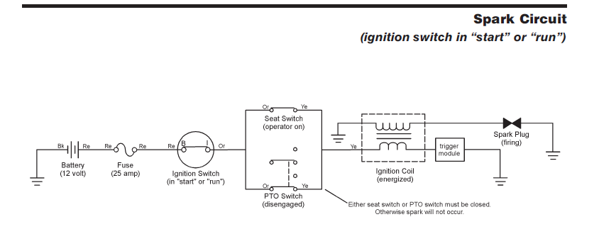

rmaynard 16,552 #2 Posted June 11, 2015 (edited) I don't have a wiring diagram in front of me, but be sure all of your safety switches are working, and check your fuses and the fuse block.EDIT: Here is the wiring diagram for the spark circuit.Check your seat switch, and make sure the PTO is disengaged. If the fuse is okay, check the fuse block as it can get corroded and cause problems, Edited June 11, 2015 by rmaynard Add wiring diagram. Share this post Link to post Share on other sites
