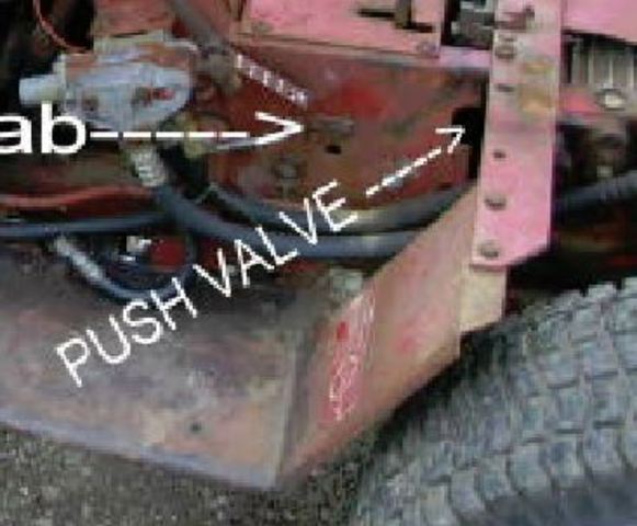

daveoman1966 3,882 #6 Posted June 8, 2015 Tow valve is on left side, here is a bad pic of it...but you can see the location, at least. It is difficult to get to and probably stuck. 1 Share this post Link to post Share on other sites
snowhound 106 #7 Posted June 8, 2015 Thanks for the photos Dave Share this post Link to post Share on other sites

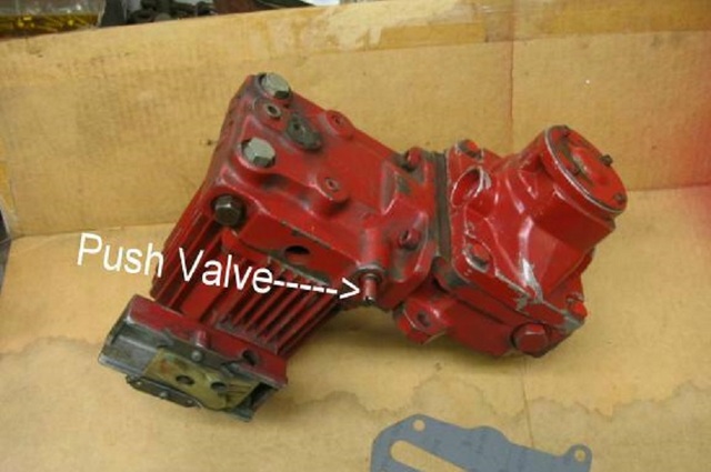

Wheelhorsegt14 1 #8 Posted March 10, 2017 What is the correct position for the push valve? Share this post Link to post Share on other sites
daveoman1966 3,882 #9 Posted March 10, 2017 To close the PUSH valve, turn it all all the way CLOCKWISE, until it bottoms out. Share this post Link to post Share on other sites
