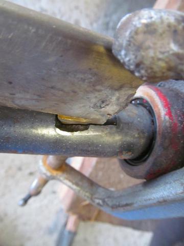

Searcher60 209 #38 Posted December 23, 2022 On 6/7/2015 at 4:14 PM, Ed Kennell said: In a previous post of my Commando 8 redo, I discussed repairing the wallowed out key way in the axle. Instead I replaced the 3 speed with one I had on the shelf. Today while rooting out some potential items for the SHOW, there was that 3 speed. So today I made a stab at the repair. I made a dummy key from a piece of 3/16 brass , welded around it, and ground/filed it down. Only time will tell if the weld will hold up to the torque. What welding process did you use that did not melt the brass? Great job! Thanks. 2 Share this post Link to post Share on other sites
Ed Kennell 47,043 #39 Posted December 23, 2022 4 minutes ago, Searcher60 said: What welding process Just an el-cheapo Harbor Freight mig with 0.035" flux core wire. Share this post Link to post Share on other sites
