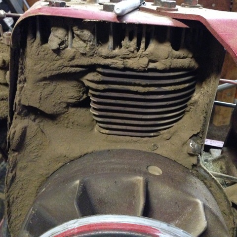

'64 1056 4 #32 Posted July 3, 2015 Back to the horse - I recently had the same symptom and mine didn't end well, loud knocking. The photo is what I discovered upon removing the flywheel cover - probably 49 years of dust. I think it overheated (maybe oil was too low also, it was at the bottom of the range on the dipstick). The rod is broken but I haven't gotten it completely disassembled to assess other damage. At first I suspected a stuck valve but they are working correctly. I'll be cleaning and inspecting under this cover to prevent this from happening again. 2 Share this post Link to post Share on other sites
woodchuckfarmer 333 #33 Posted July 5, 2015 I never seen one that bad. Share this post Link to post Share on other sites
JERSEYHAWG / Glenn 4,590 #34 Posted July 5, 2015 Holy smokes, packed to the gills. Unreal all the schmutz in there. Thanks for posting that pic. Glenn Share this post Link to post Share on other sites
Kelsey 94 #35 Posted July 6, 2015 "..................Kelsey sneaks down and uses the leaf blower onthe C-100's Kohler one more time for good measure." 1 Share this post Link to post Share on other sites
Coadster32 793 #36 Posted July 6, 2015 I never seen one that bad. X2 Share this post Link to post Share on other sites
