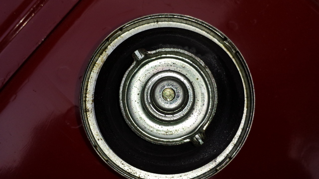

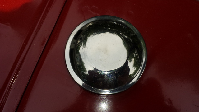

JERSEYHAWG / Glenn 4,499 #3 Posted June 6, 2015 Bob, my cap is new. I thought of that as there is no vent hole in the top. This replacement cap has been used by others on red square. My old cap, I still have it somewhere, would leak gas out from the tank and drench the top........I never could figure how this new cap "let air in". I guess as good a place as any to start. Thanks.fellas, who has a number on a differant can with the vent hole jn the top. Big thanks,,,,,,Glenn Share this post Link to post Share on other sites
JERSEYHAWG / Glenn 4,499 #4 Posted June 6, 2015 Here's the new cap. Seems to vent from the underside. I just dropped it to and dented it. Lol...what luckglen Share this post Link to post Share on other sites
Racinbob 12,432 #5 Posted June 6, 2015 That's how that one is designed to work Glen but maybe something is wrong with it that we can't see. 1 Share this post Link to post Share on other sites

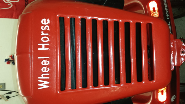

JERSEYHAWG / Glenn 4,499 #22 Posted June 21, 2015 Ok, I just had a opportunity to install the new condenser as suugested. Went for a mile and a half cruise, no sputtering, spitting, miss fireing or anything. Worked like a charm. And was the cheapest thing to try first Big thanks fellas. And as a side note, Many months back I asked how you guys do the white paint lettering on the hoods and such, I put the 854 hood on the 520 seat and decided to try out my medium point oil base white sharpie pen, worked great.so thanks for that tip also.......Glenn Share this post Link to post Share on other sites
Brian01 481 #23 Posted June 21, 2015 Post some pics!!! Share this post Link to post Share on other sites
JERSEYHAWG / Glenn 4,499 #24 Posted June 22, 2015 3 Share this post Link to post Share on other sites
JERSEYHAWG / Glenn 4,499 #25 Posted June 22, 2015 Sorry its sideways, not sure why that is. But it looks great to me, the finishing touch,,,,,allmost. Forgot, have to do kohler on the engine.Glenn Share this post Link to post Share on other sites
