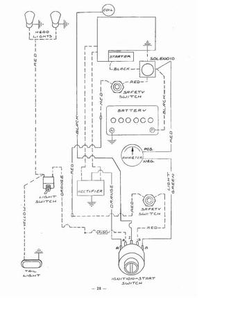

gwest_ca-(File Mod) 11,513 #7 Posted June 9, 2015 (edited) I take it you have everything working again?To switch to battery ignitionThe points are the same for magneto and battery ignitionCondenser needs to be Kohler # 230722 (Napa 7-01338)Ignition coil Kohler # 231281 or 47-145-01 (Napa 7-01634 includes the mounting bracket)New spark plug wire with wire core and terminals each endIgnition switch Toro # 103990 (Napa 7-01892 has a 9/16" mounting stem) Your mounting hole may be 5/8"Ignition switch 5-wire connector with 18" leads you can splice in (Napa 7-01910)Starter solenoid 3-pole with grounded base (Napa 7-01855) or one commonly used on older FordsMost battery ignition switches to the end of 1973 had 4 key positions which are still available but expensive - #.101917 replaced by 92-6785This is a 1974 wiring diagram for the C-Series tractors from this manualhttp://www.wheelhorseforum.com/files/file/1959-tractor-1974-c-120-om-wiringpdf/If you don't have the ammeter or safety switches the wiring is the same - just leave these items out.A 1972 Kohler service manual lists the spark plug gap at .025" for the 10hp-16hp models but later manuals call for a .035" plug gap.Garry Edited June 9, 2015 by gwest_ca Share this post Link to post Share on other sites
