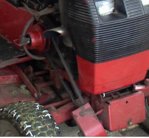

The belt should be on the INNER pulley...as in your pic, so that much is correct.
1)There are two spacers in the mule drive...one is a bit wider than the other.  One is between the 2 pulleys and the other is between the outer pulley and the metal shield....put the wider shim there.
2) Are you sure you have the deck and the mule drive mounted correctly.  In your 2nd pic, I should NOT be able to see the bottom of the BLUE belt below the frame, but I can. That is to say, the bottom leg of  the belt should be routed back toward the center of the tractor....not to the right side like in your pic.  Something is definitely wrong there.   It seems that your deck is mounted too far to the right, or you have an incompatible deck.

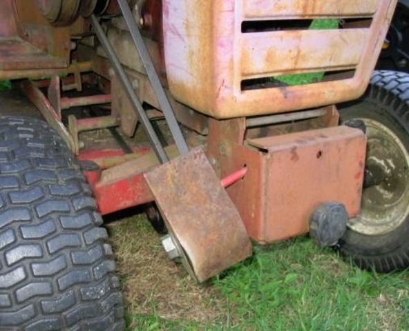

Here are pics of how the belt should be routed, and the approximate angle you can see as it goes back under the tractor, to the middle of the deck.  (Both are 42 side decks in my pics on a C-0120 and a 314-8)

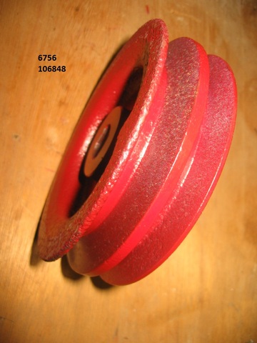

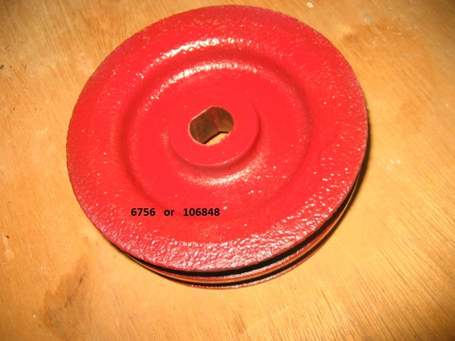

daveoman1966
The cast iron center pulley for that model 48" mower deck is # 6756 and the new part # is 106848.
I HAVE THAT PULLEY....NEW.   It is listed on Ebay.  I also have other parts for that deck....
