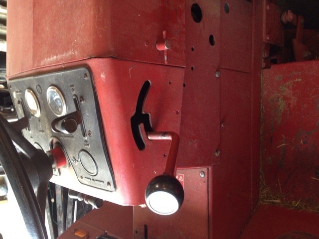

alswagg 128 #1 Posted June 1, 2015 i picked up this D series a couple weeks ago. The motion control lever has a park detent none of my other D's have this same configuration. It works fine just asking. Share this post Link to post Share on other sites
pacer 3,179 #2 Posted June 1, 2015 My '75 D-180 has the park configuration like yours but I learned long ago not to use it, the linkage would get out of sync? and I'd have get a screwdriver or similar and fish it back together so I pretty quickly decided to avoid using "park"In this same vein, I have a D-160 (unknown year) with the park notch and at some point someone put a 'block' plate over it, its nicely done and I wonder if maybe it wasnt a dealer install?Then I have a 18 auto and it doesnt have the notch... Share this post Link to post Share on other sites
pfrederi 19,940 #3 Posted June 1, 2015 My d200 has the extra notch but the linkages don't use it. There is a parking brake handle below the instrument panel. I guess they were using up old hoodstands. The block out sounds like a dealer thing to avoid operator issues/questions. Share this post Link to post Share on other sites
alswagg 128 #4 Posted June 1, 2015 Mine has a neutral safety switch also. All tthe linkage works smooth and reliably. Nice tractor but very ugly. Paint and new graphics are on the way. 1 Share this post Link to post Share on other sites
ericj 1,579 #5 Posted June 2, 2015 my dad bought my D200 back in 75 or 76 and i believe the dealer we bought it from had already blocked the parking brake off do to people accidentally putting the tractor into park when changing directions and damaging the transeric j Share this post Link to post Share on other sites
