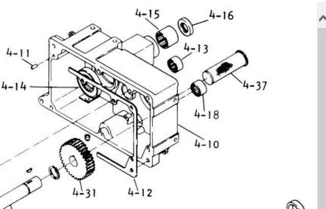

pfrederi 18,804 #3 Posted May 30, 2015 When I redid the transaxle on my D there was one needle bearing that I couldn't find a replacement for and had to reuse. Now i will sit and think to try and remember which one it was....I think it was one that was in the trans case where the hydro motor attaches.I think (it was #8049) 4-18 in the diagram The WH # was changed to 5960 and it is NLA. I remember a lady at motion industries did some searching for me and couldn't find a replacement. it is a short bearing and there is no room for a longer one. Share this post Link to post Share on other sites

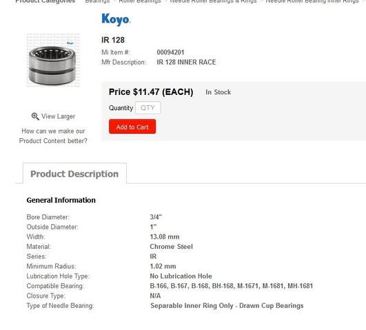

pfrederi 18,804 #7 Posted May 31, 2015 The M1681 no longer shows up on my bearing suppliers site. However it appear there is a Koyo substitute. IR-128 Share this post Link to post Share on other sites
gwest_ca-(File Mod) 11,594 #8 Posted May 31, 2015 (edited) The M1681 no longer shows up on my bearing suppliers site. However it appear there is a Koyo substitute. IR-128 I think it should be for a 1" shaft. Do they have a IR-168?M1681 would be an open bearing.Garry Edited May 31, 2015 by gwest_ca Share this post Link to post Share on other sites
pfrederi 18,804 #9 Posted May 31, 2015 It has been a long time since i actually saw the bearing in question but i think it was on a 3/4" shaft.From Motion industries they now think the Koyo IR-128 is a substitute for the M1681...strange the lady didn't seem to find that a few years ago when i inquired>>>> Share this post Link to post Share on other sites
stevasaurus 23,355 #10 Posted May 31, 2015 Like Garry stated...M-1681 would have a 1" ID x 1 1/4" OD x 1/2" height...it is also what I call a "cap" bearing. ie, it is closed on one side. If Andy has an open case there, maybe he can measure this rascal. Share this post Link to post Share on other sites

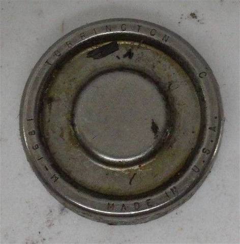

wheeledhorseman 579 #11 Posted June 1, 2015 Had a look at the bearing in question today hoping to see a manufacturer's reference on the end cap but both roller bearings that are visible with the hydro motor removed had no markings at all. At a guess the original WH 8049 bearing was produced for WH / Sundstrand without any manufacturer's markings.I'm basing the fact that the WH 5960 bearing used as a later replacement was actually a Torrington M1681 from a photo of a NOS 5960 listed for sale which shows the Torrington reference markings on it but as you say measurements are really needed to confirm this.The M-1681 is certainly from the photo a cap bearing. I'll be splitting the transmission case during the week so I'll be able to remove the bearing for measurement and will keep you posted.The Koyo IR128 is I think an open ended bearing so not a suitable replacement despite what they say. There is a Koyo M-12121 thats a cap bearing and the same ID / OD size as the IR128 but it's 3/4" wide not 1/2". So in answer to the age old question - size does matter! Share this post Link to post Share on other sites
