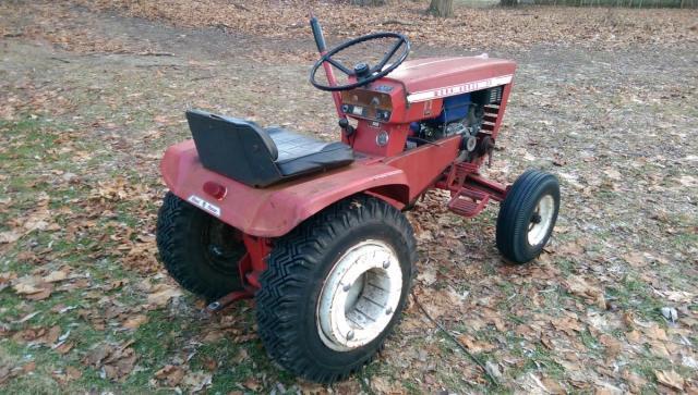

stratostar250 934 #1 Posted May 26, 2015 So, I put on the mower deck that came with my Work Horse 700 today because I am selling my C-105 which I used last year for mowing duties. It was then that I realized that the spring that hold the pto engagement pedal back was broken, so i'd have to hold it with my foot until I get a new one. I looked for the spring, which is part number 5714, but is discontinued. What have you all used for replacements? Thanks for any info! Share this post Link to post Share on other sites
gwest_ca-(File Mod) 11,762 #2 Posted May 26, 2015 It may be discontinued but there is a chance it is still available from Toro. They still have it priced which is rare when discontinued. Could also be a mistake on their part.http://www.partstree.com/parts/They are rather proud of the 5714. If you do get one post a full description of it so we know what it takes to replace it.Garry Share this post Link to post Share on other sites
stratostar250 934 #3 Posted May 26, 2015 (edited) I'll see what I can find out, That is true, it just says discontinued, not NLA, which is a plus! And I'll do what I can to show the replacement! Taking it off was a slight challenge, so I cant imagine putting on a new one............. Edited May 26, 2015 by stratostar250 Share this post Link to post Share on other sites
