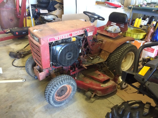

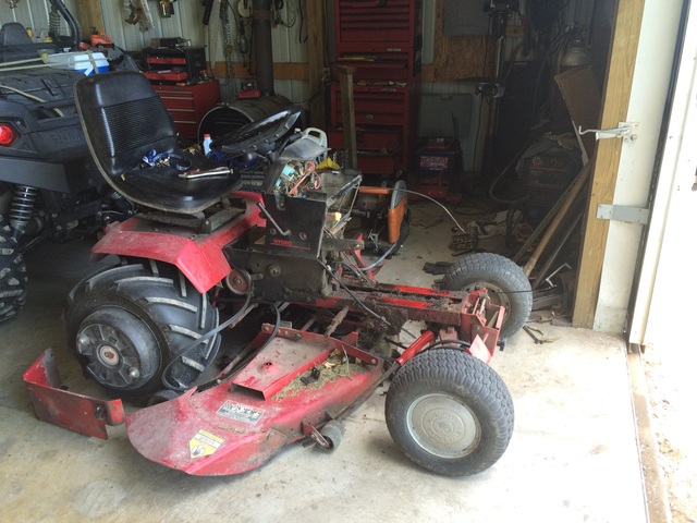

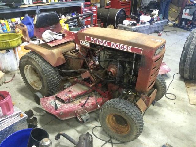

nmassey02 13 #1 Posted May 24, 2015 (edited) Hey guys I'm new here, but I figured I would share my project I have going on. My neighbor was going to take his old c-100 to the land fill and I asked him about it, he said if I wanted it, it was mine. So I picked up for free! I have a 520-H that I'm pulling the onan off of and using it to power the c-100. My later plans are to put the hydrostatic rear end under the c-100 too. Yes the 520 was in perfect running shape, but I never was fond of that body style, so I'm building one! Edited May 24, 2015 by nmassey02 6 Share this post Link to post Share on other sites

Racinbob 12,045 #4 Posted May 25, 2015 I never would have thought it would fit with that style of hood but it looks like it grew there. Glad you saved it from the landfill. Share this post Link to post Share on other sites

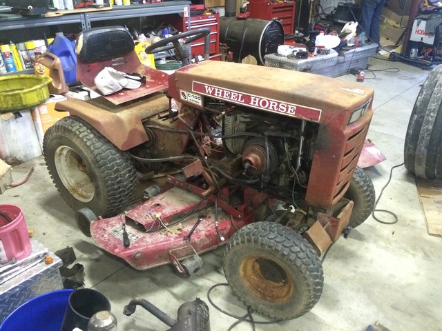

nmassey02 13 #5 Posted May 25, 2015 I got it fully mounted, and wired to run. Threw gas to it and it fired right up. The onan on the 520 wasn't charging, but the kohler on the c100 was. So I wired the onan to the kohler voltage regulator and it's charging again! That saves about $60 for an onan voltage regulator. The gas tank seems like it should fit in the factor location but the battery will not. So I have to figure out a spot to mount it, I'm thinking under the rear seat pan. I couldn't drive it around as the drive belt from the c100 wasn't long enough so possibly sometime this week I'll pick a belt to fit it. Also the pto arm wasn't long enough to to reach the onan so I'll have to switch that part over from the 520 1 Share this post Link to post Share on other sites

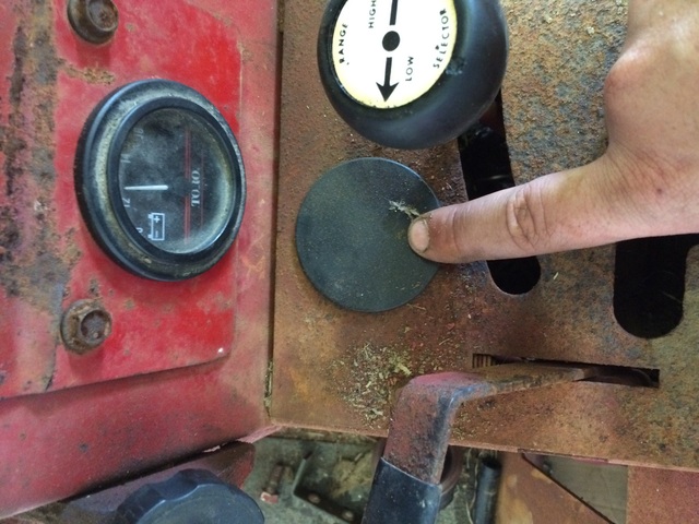

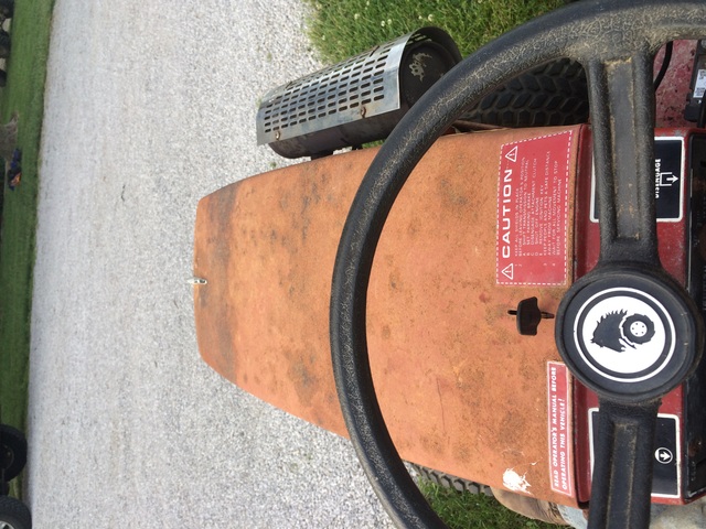

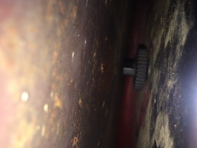

nmassey02 13 #6 Posted May 28, 2015 Got a little more work done today, I removed the exhaust so the hood would fit on. The throttle and choke cables from the kohler were long enough but needed to be switch around to have the throttle and choke levers on the right ones. Today I also managed to swap them around so they would be correct. I took a picture of how much room there is between the top of the carb cleaner and the top of the hood. Also I replaced the ammeter with the factory one from the 520, and there was a capped over gauge hole by the shifter on the c-100 so it's going to get the rpm tach from the 520 also. The muffler got the pipes cut off of it as well. Progress is going quite well. Share this post Link to post Share on other sites

nmassey02 13 #9 Posted May 29, 2015 I was able to get a drive belt today, along with lengthening the onan's exhaust. The hood completely bolted and mounted now. It won't let me upload any more pictures, I can upload anything file over 1.89MB right now for some reason. Share this post Link to post Share on other sites

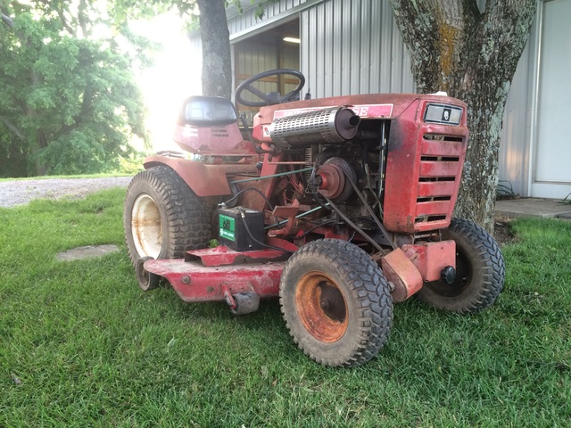

nmassey02 13 #15 Posted June 9, 2015 Hey guys I know it's been a while since I've updated. Instead of building a new box for the battery, I discovered the battery off my four wheeler would still fit in the factory location. I put it on the mower and it spun the onan right up, so I went out about bought a battery to fit it. Then I wired up the head lights and swapped the back wheels and wheel weights from the 520 onto the c-100. Next I'm going to try and swap the 520 front axle to the c-100. I've been mower the past couple of days with the c-100 and everything seems to be functioning just fine. I've had a few little electrical problems here and there but that's to be expected with this kind of swap on the first go around. 1 Share this post Link to post Share on other sites
