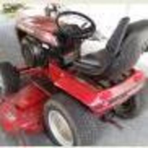

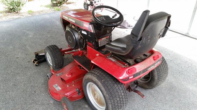

Hello, I just bought a sweet 520H and it came with a 44 inch dual stage snow blower. I noticed it is missing the lift rod #6 and spring support #9 for it. Does anyone have information for size and or pictures so that I can make one?

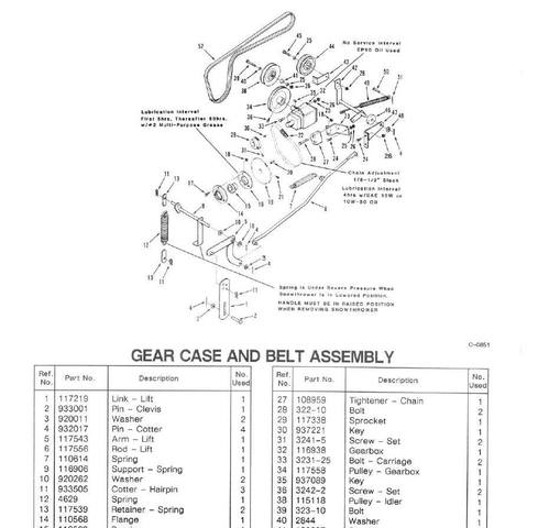

welcome to the group.Go onto partstree.com and they should have what you need.

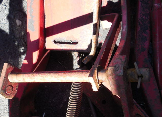

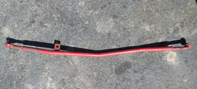

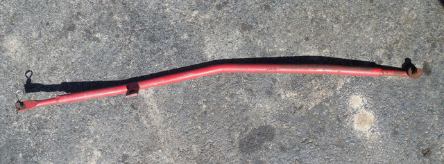

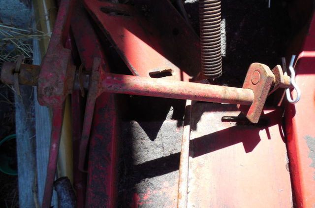

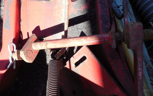

I have my 2-stage blower in pieces for a rebuild.  Here are some pics of 6 and 9 if they help.  Not the best quality, but its what I have.  If you decide to fabricate some yourself, let me know and I'll get some dimensions and better pictures for you.
Kurt.
