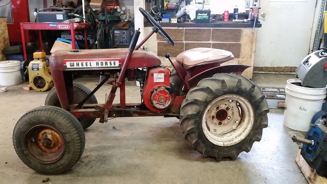

jeremi3210 742 #1 Posted May 18, 2015 Picked this little gem up today my very first rj58. Runs good trans feels good. Couple of questions, how do you check the trans oil? Also are the wheel horse decals oe? And is the clinton the right motor or should it be a k91 kohler? 4 Share this post Link to post Share on other sites
wallfish 18,423 #2 Posted May 18, 2015 NICE SCOREClinton is correct if it is a B1290Decals are not correctLook on the right side panel of the trans for a plug. 1 Share this post Link to post Share on other sites

jeremi3210 742 #4 Posted May 18, 2015 Another question, what size is the drive belt? Oh and it came with a deck and a nos set a blade tips. Share this post Link to post Share on other sites

wallfish 18,423 #6 Posted May 18, 2015 (edited) belt is 1/2 w by 29 LBTW it's easier to drain the trans by removing one of the lower bolts and easy to refill through the shift lever hole after removing the shifter Edited May 18, 2015 by wallfish 2 Share this post Link to post Share on other sites

jeremi3210 742 #9 Posted May 19, 2015 Ok I found the check plug for the trans and it doesn't want to budge. Anyway my question is what grade and how much oil goes in these? Share this post Link to post Share on other sites
neil 2,410 #10 Posted May 19, 2015 If you check the download section you can download the RJ58 manual.great find , enjoy 1 Share this post Link to post Share on other sites
