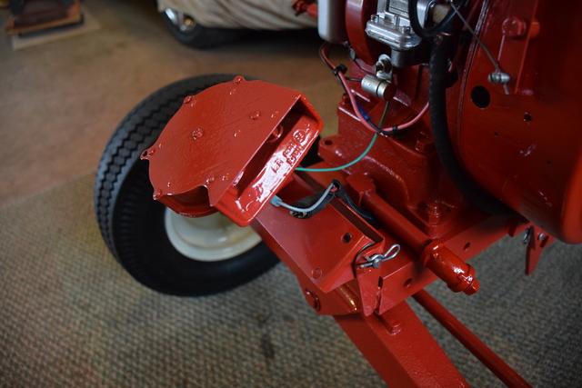

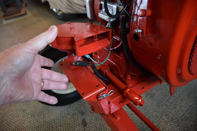

george.stringer@frontier.c 0 #14 Posted May 31, 2015 You can go either way with your horn. If you decide to not install a relay you will need a switch capable of passing high amperage. If you install a relay it will cut the amperage at the switch and you can use mini push button switch. Carefully remove the tin cover on the relay by bending the attaching prongs straight. Use an ohm meter to see where the current goes when the blade on top of the coil is closed. That post is where you attach the wire going to the horn. Two other wires are needed - one to + bat and one to - ground. Put your horn switch in the ground circuit with your fuse in the + circuit. If you use a Delco Remy horn it can be mounted on the hood hinge above the axle. I will insert some pictures. If you have more questions email me at george.stringer@frontier.com. The picture with my hand in it shows the horn position with the hood closed. George Share this post Link to post Share on other sites
