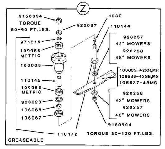

scraper 4 #1 Posted May 15, 2015 I am almost done rebuilding my deck. I was looking thru the manual and could not find the proper torque for spindle nut holding the pulleys down, anybody know the right torque for deck # 78360. Share this post Link to post Share on other sites
gwest_ca-(File Mod) 12,164 #2 Posted May 15, 2015 You likely have a lock washer and standard nut above the pulley like this. This design eliminated the Woodruff key between the shaft and pulley. Make sure you use Never-Seize so the pulley will come off easily next time. One operator manual I looked at says 80-100 Ft. Lbs. for the blade nut which is different than this illustration. Garry Share this post Link to post Share on other sites
