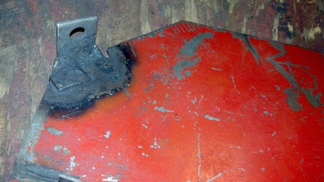

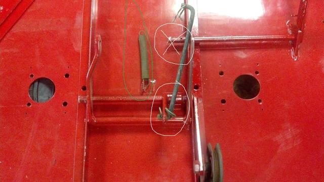

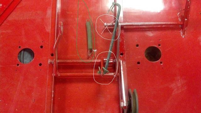

RedRanger 1,470 #1 Posted May 15, 2015 Just bought a 401 that came with the 3261 deck. Problem is the deck was disassembled 5+ years ago, refinished and painted. Parts came to me in two boxes and a few baggies of bolts. I've printed the manual and studied the exploded view. I think I'm missing a pivot link and maybe a spring or two to tension the clutch. I'm also not sure if I have the correct deck lift link or exactly what the assembled version should look like. Here is a pic of the parts in question. I also have all the housing, bearings, spindles, gears etc. but that all looks to be complete. The item circled in white is a Pivot Link. Should I also have one of these where the white X is? Is the black clutch link the correct one? It seems too long? Where do the tension springs attach? Does anyone have a picture of an assembled 3261? Thanks folks! Share this post Link to post Share on other sites

RedRanger 1,470 #3 Posted May 15, 2015 Thanks Garry-I've already reviewed those and studied and printed the 1961 version. I'm hoping for an actual photo of a 3261 assembled. Can't find one anywhere on the web that shows the middle of the deck with all the components. I think I'm missing item #52 on the chart-one of the pivot links WH#3722 and my clutch linkage just doesn't look like it belongs. steve Share this post Link to post Share on other sites

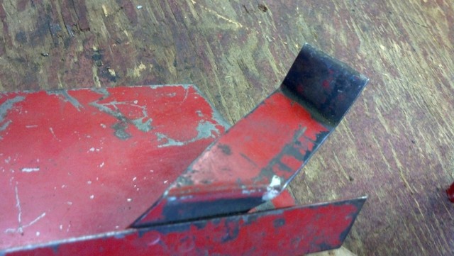

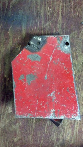

RedRanger 1,470 #4 Posted May 19, 2015 I definitely need one of the pivots if anyone has one, but can anyone confirm what length the clutch connecting rod should be? The one that I have is way too long.Also, does anyone have pictures of the correct setup for the belt guard brackets? Mine has been mutilated.Thanks. Share this post Link to post Share on other sites
