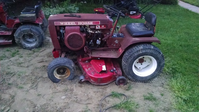

badhorse800 0 #4 Posted May 18, 2015 (edited) well here it is, the deck fit real nice my only problem is the mid connection quick release is missing a part, so I will be remedying this hopefully this week-Spenser Edited May 18, 2015 by badhorse800 Share this post Link to post Share on other sites

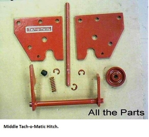

daveoman1966 3,882 #5 Posted May 18, 2015 Here is the complete mid hitch....what part is missing on yours? Share this post Link to post Share on other sites

badhorse800 0 #8 Posted May 18, 2015 I am missing the spring loaded release but right now I am only going to be having the mower deck attached to it so I am going to run a bolt through one of the holes in the non moving part to keep the swinging part locked on, that way I can put off spending a little more money on this project.Spenser Share this post Link to post Share on other sites
