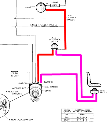

Save Old Iron 1,573 #4 Posted May 13, 2015 (edited) there are two ways for battery voltage to enter the ignition switch thru the PTO (red) on the B terminal and apparently thru the seat switch (purple) on the R terminal. How is the seat switched bypassed ? wires shorted together or separated and insulated from one another ? Edited May 13, 2015 by Save Old Iron 1 Share this post Link to post Share on other sites
Save Old Iron 1,573 #5 Posted May 13, 2015 The switch "map" for the tractor shows these terminals connected together in the RUN position In the OFF position - no connections between any terminals And in the START position 2 Share this post Link to post Share on other sites
Save Old Iron 1,573 #6 Posted May 13, 2015 Ignition switch appears to test OK I guess I will get double duty this week from the diagram below. Tell me which test point (1 to 5) you have battery voltage present Share this post Link to post Share on other sites

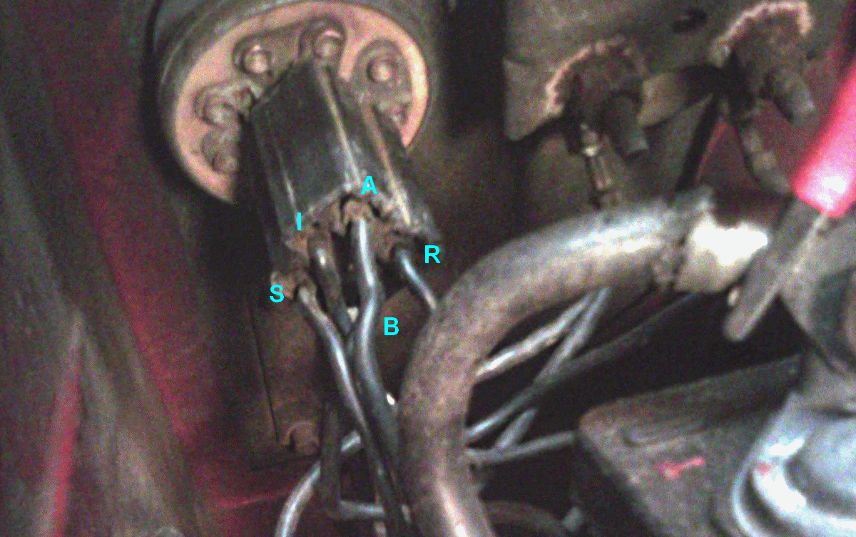

bo dawg 536 #7 Posted May 13, 2015 (edited) Hey SOI I was hoping you would chime in. Sorry I'm at work and just check the post. If you can see in the picture (sorry its from phone) My wires are a bit different than your diagram, all wires black, going by memory. Coming from the battery, is the wire lead to ammeter, then out to PTO switch (2 prong), then comes out other post of PTO to the B post of ign switch. Also a 2nd wire from ammeter feeds to regulator. Now here's the problem, there's also a wire coming off the PTO to the seat switch which is hot and comes back from seat to A post of ign, giving it 2 hots going into ign. The I post of ign go's to the coil, from the R post go's to lights and hr meter. (which cant get power to). Then from S post go's to solenoid. The seat switch is by-passed with a jumper wire with connectors. The pedal switch is by-passed too just wired together and soldered. When key is in the off position the B post and A post on ign is hot, the PTO post are hot, the ammeter post are hot. Fuses are good. And nothing on I and R post. But then when key is in run position everything else go's dead. Funny thing is this is the way it has been since I have owned it and has ran well till I took apart the fender pan and gas tank to clean all the crud out from under and around. Edited May 13, 2015 by bo dawg Share this post Link to post Share on other sites
bo dawg 536 #8 Posted May 13, 2015 (edited) For the most part the wiring all looks good, doesn't look all hacked up other than the switches by-pass. The wires have small white numbers but cant read all of them. Also cant remember if I had power at the solenoid from S post of ign when key turned to start or not. I will have to check tonight. But according to you maps I think ign switch is good. Edited May 13, 2015 by bo dawg Share this post Link to post Share on other sites
Save Old Iron 1,573 #9 Posted May 14, 2015 (edited) there's also a wire coming off the PTO to the seat switch which is hot yes - wire TO the seat switch should be HOT at all times - the wire FROM the seat switch to the ignition switch ® terminal should be hot when operator is in the seat. If the seat switch is bypassed by connecting both seat switch wires together, obviously both wires will be HOT at all times. and comes back from seat to A post of ign, this may be an issue?? The wiring diagram shows the seat switch wire going to the "SEAT SWITCH" terminal of the ignition switch. This terminal, by process of elimination, has to be the "R" terminal on the ignition switch. giving it 2 hots going into ign. The I post of ign go's to the coil, OK from the R post go's to lights and hr meter. (which cant get power to). This doesn't make sense. As I said before, the seat switch wire shows on the schematic as going to the "R" terminal - and doesn't it make sense the "accessories" like lights, etc should come off the "A" terminal? Then from S post go's to solenoid. OK too. When key is in the off position the B post and A post on ign is hot, the PTO post are hot, the ammeter post are hot. Fuses are good. And nothing on I and R post. According the to schematic - and logically - the "B" and the "R" terminals should be HOT. The "A" accessory terminal should not be HOT until the ignition switch is in the RUN position. The "A" terminal should be considered OUTPUT for power not and INPUT. "B" is power in "R" is power in "I" is power out to coil "A" is power out to accessories "S" is power out to starter relay Funny thing is this is the way it has been since I have owned it and has ran well till I took apart the fender pan and gas tank to clean all the crud out from under and around. I can believe the wiring to the seat switch could have been disturbed when you did this. I would suggest double checking the "bypass" for the seat switch and the wiring to and from the switch. I have attached an enhanced section of your phone pic of the ignition switch wiring. They way the ammeter and ignition switch terminals appear to be corroded , I can imagine some gremlins might be hiding in the ignition switch female terminals. At the very least, I would swapout the 5 corroded female terminals in the ignition switch connector and recheck the seat safety switch bypass connection and wiring by the gas tank. Edited May 14, 2015 by Save Old Iron 1 Share this post Link to post Share on other sites
bo dawg 536 #10 Posted May 14, 2015 (edited) scan0001.pdf I put a picture of the safety seat by pass, I put new connections on jumper wire but still the same. It's hot coming back. I also for kicks show a picture of the pedal safety by pass. I downloaded a wiring diagram out of the wheel horse manual of what I'm going by showing the R post is for lights and A post is for seat switch. But I agree with you thinking they should be the opposite. But this is how the tractor was and everything was working before, lights and all. This is killing me. I can cut the ign plug off and go with new individual connectors, I took some fine sand paper and cleaned up the prongs of the ign switch the other night so their good. I know the ammeter looks cruddy but it gets good voltage in and out but I can try to clean if they don't break off. Lol! Question... why then when I turn key to run position everything gos dead? even dead at the ammeter post, kinda like going backwards. Edited May 14, 2015 by bo dawg Share this post Link to post Share on other sites

Save Old Iron 1,573 #14 Posted May 14, 2015 scan0001.pdf I downloaded a wiring diagram out of the wheel horse manual of what I'm going by showing the R post is for lights and A post is for seat switch. But I agree with you thinking they should be the opposite. But this is how the tractor was and everything was working before, lights and all. This is killing me. I see the confusion. The pictorial of the ignition switch does show the "A" and "R -seat switch' terminals reversed from a real life 103990 switch. Given the tractor has worked properly in the past with the wiring CONFIGURATION as is, we need to shift gears and investigate the battery to switch wiring QUALITY. Share this post Link to post Share on other sites
